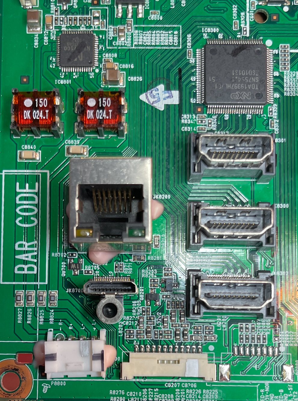

I've got an old television set, an LG model 55LE5400. This TV and I have been through a lot together. I've had to replace its mainboard with ebay parts three times now, because these sets have a well-known tendency for some of their main CPU's BGA pins to work loose after several years of service. The repair method is to either fully reflow and pray, or just buy a known-working mainboard to replace it. The TV has recently had its mainboard replaced, so it's working fine at the moment. I have also recently moved it from being a main living room TV to being a secondary TV that lives in my studio, for gaming and secondary TV watching. It's not *quite* ready to be sent to that farm up north yet. But in its current role, I am thinking I'd like to "mod" the thing to have a line-out for some powered speakers. I'm trying to identify the best place on the board to tap into the line-level audio lines before they hit the TV speaker's amplifier circuit. I'm hoping that the magic of the Empeg BBS can help me find just the right place to tap in. Here's why I want this unusual configuration: - I already have a stereo pair of nice self-powered speakers hooked up to the TV's headphone jack. Actually these speakers are some small near-field studio monitors I had lying around spare, so they sound pretty nice. I'm using one of those adapter cables which turns a 1/8" headphone jack into two RCA cables, and running the RCA outputs to the speakers' line level RCA inputs. This works more or less fine as-is; even though the headphone output isn't really line-level, it's at least low-powered enough not to overdrive those speakers. The TV's remote control is successful at adjusting the volume, and everything works as designed. - I want to keep that basic layout, and keep using that pair of speakers. I don't want to buy any A/V receivers, add any additional remotes, or add any other major new components. I'm aware that my additional issues below would be solved by an A/V receiver, but I have several reasons for not wanting to add that level of complexity at the moment. - My main issue: When something is plugged into the TV's headphone jack, it turns off all of its audio-processing features and grays them out. Through the headphone jack, it delivers pure plain stereo output without any audio processing. It turns out that there's one audio processing feature on the TV that I'd really like to use (called "clear voice II"), but I can't use that in its current configuration, due to this limitation. - I could unplug the headphone jack, forget about the powered speakers, and just use the TV's built-in speakers. This works, it allows all of the audio-processing features to succeed, however, the built-in TV speakers are small and tinny and sound terrible. - I have tried using the TV's fiber-optic cable output, running that to a little Toslink-to-RCA converter box, to drive the powered speakers. This produces sound to the speakers, but, it doesn't solve the problem because it adds two new additional problems: I lose volume control. The volume of the TV's fiber-optic cable output is not controlled by the TV's remote control; the remote still controls the volume of the tinny TV speakers. And if I use the TV's settings menu to turn off the TV speakers, I still can't control the volume of the Toslink output, and ALSO the audio processing features get grayed out again. In fact, I'm not convinced that the audio processing features are even working on the Toslink output at all anyway. So I'm thinking that what I'd like to do is find the line-level part of the audio signal chain on the mainboard, right before it amplifies the sound for the TV's built-in speakers, tap into that, and turn that into a pair of RCA line-outs coming out the back of the TV. I could then unplug the connector to the TV's internal speakers, so that the remote's volume controls only the RCA line-outs and the TV speakers are silent. I believe I've identified the correct section of the mainboard, but I'm having trouble finding the datasheets for the audio amplifier chip and other components, so I don't know the pinouts. I have faith that the folks here would be able to help ID the bits I need to mess with? I have three of these mainboards that I can experiment with at the moment: The primary one is the golden fully functional one, running in the TV right now. The second one is non-functional due to a failed reflow attempt on its main CPU; I could do practice soldering on that board perhaps. The third one is intermittently functional if I push down on the CPU's heatsink; I could use that one for testing that the mod actually works. If it works, then I could implement the final mod on the golden board. All three boards are different revisions, and have slightly different component part numbers, but are basically the same. I'm including photos from the second and third boards so that we can ID the components and their pinouts. Non-functional board: IMG_4886.jpg - NTP-7100 DOJ073AG 1032 - Audio amplifier chip. IMG_4885.jpg - 150 DK 024.T - Possibly audio amplifier transformers? IMG_4884.jpg - Wide shot: Audio amplifier at top, transformers below, connector to TV speakers at bottom. Intermittently-working board: IMG_4887.jpg - NTP-7000 D01518AI 1007 - Audio amplifier chip. IMG_4883.jpg - 150 DK PT. - Possibly audio amplifier transformers? IMG_4882.jpg - Wide shot: Audio amplifier at top, transformers below, connector to TV speakers at bottom. My specific questions: - Can anyone find datasheet or pinouts for the NTP-7000/NTP-7100 audio amplifier chips? I can find the chips by googling but I'm coming up dry in locating their datasheets. - Can anyone find a datasheet or pinouts for those "150 DK" components? Are they audio amp transformers as I suspect? I'm wondering if I merely need to tap some RCA jacks onto their top-right corner pinouts to get the line level I'm looking for? - Any other suggestions?
IMG_4886.jpg (82 downloads)IMG_4885.jpg (80 downloads)IMG_4884.jpg (91 downloads)IMG_4887.jpg (76 downloads)IMG_4883.jpg (75 downloads)IMG_4882.jpg (83 downloads)

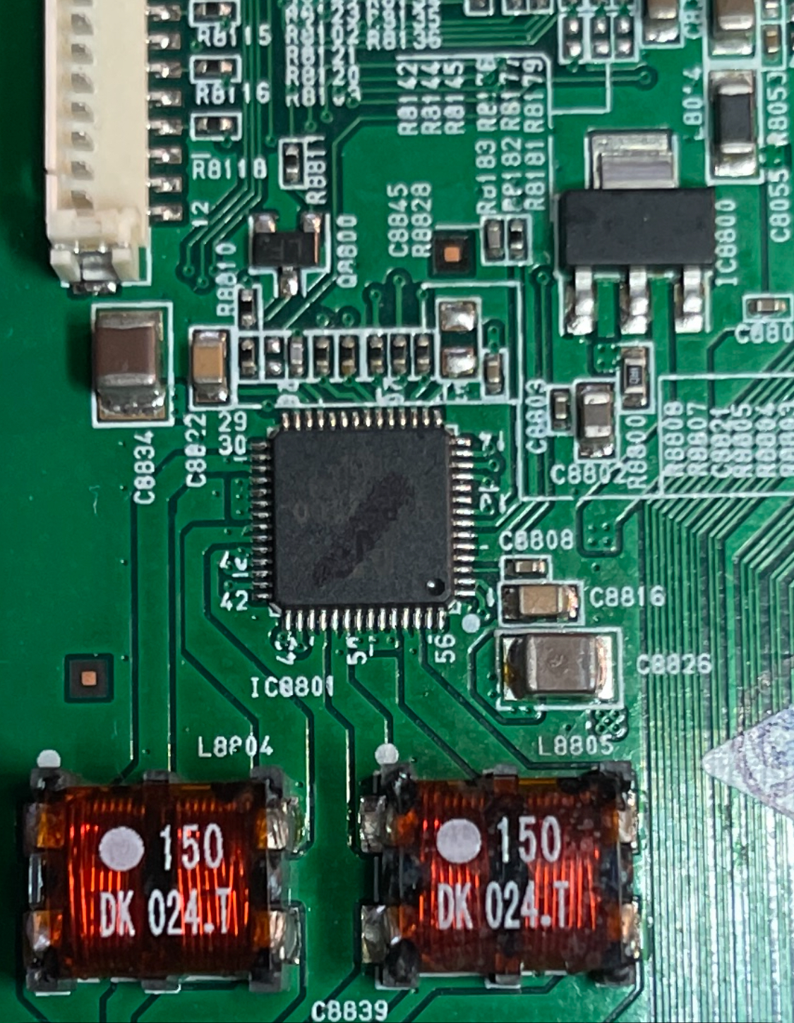

I tried, just for the heck of it, tapping into the upper pins on those transformers (using my intermittent mainboard). It got output sound to the powered speakers, but it Wasn’t line level. It was speaker level and so it was noisy and too loud for the speaker inputs. Disconnected now.
Maybe I should just get a speaker-level-to-line-level converter for this, if I can find one that isn’t a car-audio device.
#374267 - 04/03/2024 17:00
Re: Help modding TV - identifying line-level traces?

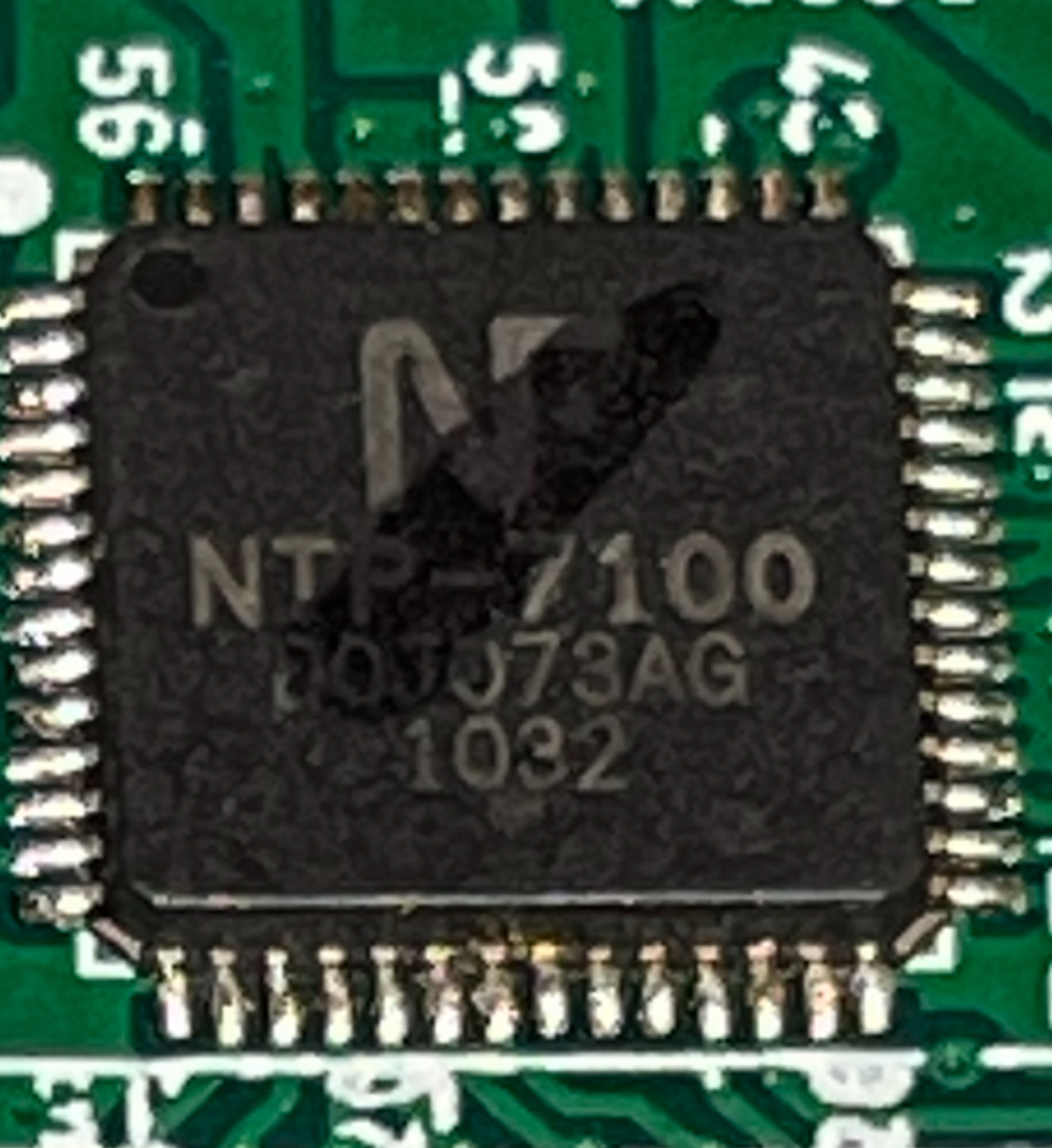

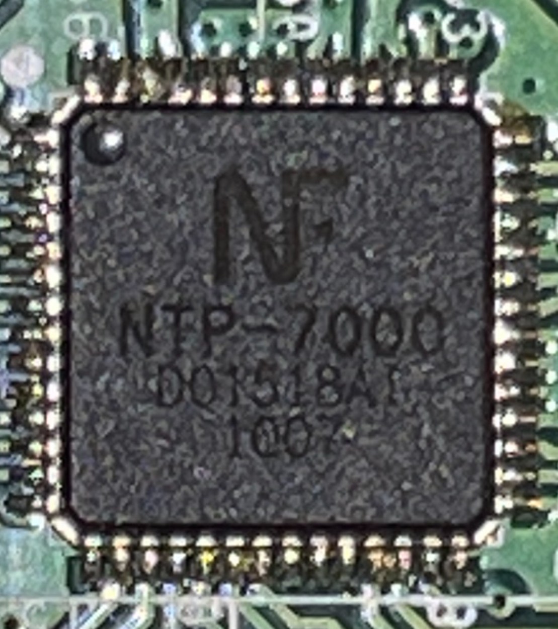

That component appears to be an integrated DAC+amp: I2S in, speaker-level out. It's not clear that there is an exposed line-level signal. A speaker-level-to-line-level converter sounds like it could work.

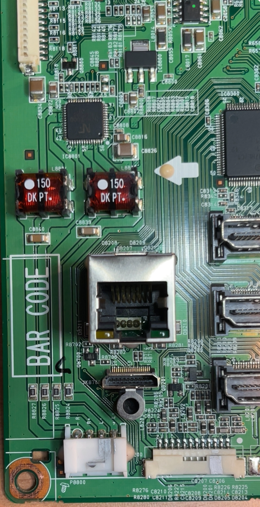

Speaker side. More details: - At the bottom left of this photo you see a small connector for the TV's four speaker wires. - Using some spare parts, I fashioned a plug that connected to that connector and had four speaker wire outs which run outside the TV. (TV's speakers are now disconnected.) - Outside the TV, the four speaker wires connect to the speaker input terminals on this Russound ADP 1.2 device. - If you look at the photos of the Russound device, you can clearly see its simple traces, and can see that it's a simple voltage divider, but the left and right channels assume a common ground. Using it in that configuration didn't produce satisfactory results, so I scraped off parts of the ground trace, making it be two independent left and right channels with no ground connection between them. That, plus changing the resistors to 10k ohm and 47 ohm, seemed to get me the results I wanted. Since I did those two things at the same time, I'm not sure which of those two modifications was the more beneficial one.

I tried doing the thing, and I ran into issues. Here's what I did: - I changed my makeshift plug, the one that plugs into the former speaker wire connector receptacle at the bottom left of this photo. I modified it so that it contained only the R+ and L+ wires at the receptacle. The dangling R- and L- were tied together and connected to the ground plane of the TV's circuit board at the screw hole that's seen to the left of the receptacle in the same photo. - I solder blobbed back over the joints that I had scraped away on the Russound ADP 1.2 so that it no longer had separated grounds, and was back to its original design. - I left my modified voltage divider resistors in place on the Russound: R1=10k 1watt, R2=47ohm 1watt. This ratio gives a Vout that's about 0.5 of a percent of Vin. This produced output which was super quiet compared to the previous configuration, unusably quiet. I thought that perhaps maybe everything was working as intended and maybe the only remaining issue was that I'd changed the ratio of the voltage divider too much with my earlier experiments. So I tried this: - I put the original resistors back in the Russound, which was R1=3.9k 1watt, R2=430ohm 1/2watt. This produced scary results! Even before any sound was played, simply turning on the TV caused a noisy hum out of the line-level outputs. More than just a 60cycle noise floor issue, this was a massive buzzy hum like something was wrong. I turned off the TV and put everything back the way it was: Re-separating the grounds on the Russound voltage divider and re-connecting all four wires back to my makeshift speaker connector plug. This made things go back to normal. I also tried different resistor values, trying R1=6.8k 1watt, R2=68ohm 1watt. This is supposed to produce Vout at about 1 percent of Vin. This does pretty well sound-wise. Because of your warnings, I don't want to shorten the life of that TV's board. I checked the temperature of the two transformers and the audio amplifier chip just above them (left center of this photo where the white arrow is pointing). I checked with my fingertips in several situations, such as playing music softly or loudly, or having the volume set at zero, and also swapping between plugging in the Russound voltage divider and plugging in the TV's built in speakers. I found that in most cases those transformers and the audio chip get pretty warm to the touch, getting warmer as volume increases. I don't have a quantitative measurement but I think that using the voltage divider makes them noticeably hotter at the same volume settings, but not by a huge scary amount. Still, it was warmer enough to worry me a little, so I've disconnected the Russound device and gone back to just running my self-powered monitor speakers from the TV's headphone jack for now.
