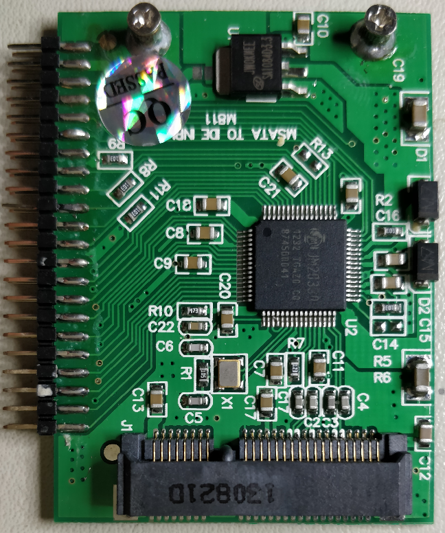

#372231 - 26/08/2019 18:42 Re: Time to refurbish my MK2A. [Re: mlord]
Found it: JM20330 bridge chip.
So.. perhaps any style SATA adapter with that exact chip might also work, including for full-size SATA SSDs ?
Description: mSATA adapter from 2014.
Description: thumbnail
Edited by mlord (26/08/2019 18:55)

The common cheap ones from 10 different manufacturers on Amazon all seem to use the same chip, same signals seem to come out the same sides of the chip and the parts surrounding the chip look roughly the same.
I'll nab one and see what happens.

Let us know how that works out. I suspect that these chips also have internal firmware, and compatibility may also depend upon the exact firmware version included.

Just ordered this one, I'll have it in a couple days:
https://www.amazon.ca/QNINE-Laptop-Adapter-Convert-Vertical/dp/B074KXB1GZ
SATA TX/RX lines match the JM20330 pinout. They've no doubt got an internal ROM in them that does everything, but at least it's internal to the chip so whoever assembles adapters can't mess it up.

Did you ever try these in your player? Keen to hear how successful this is..

Right now it + the empeg + the RAM that mlord sent me are all sitting in a box, because I'm moving houses.
Give me about a month and I'll have an answer smile

Update: RAM upgrade successful!
And the HD adapter doesn't work. Empeg won't see any drives. Won't work with a USB-to-44 pin adapter that I have, either. Drive spins up but no HD found in either case. Guess the little "QC control" sticker on the thing doesn't mean anything.

The empeg will not work with a USB-to-44 pin adapter. The empeg will not work with a IDE-to-SATA adapter. Make sure to try getting the player working with the original Winchester IDE PATA drive that it came with first, before trying fancy stuff like drive adapters.
If you are using a proper IDE PATA drive, and the player can't see any drives, then look for the possibility that it has a problem with the IDE cable or the header as described here: http://www.riocar.org/FAQ/8/221.html#221

I also spent some time getting my empeg up and running again over Christmas, as it happens. I'd forgotten how much I love the interface and the crisp VFD display!
So far, I'm also one of the lucky few having no issues with a SATA SSD. I bought a cheap adapter over a year ago to convert an old uSATA laptop drive to 44 pin IDE, with the plan of using it in the empeg, just assuming it would work.
When I actually came on the forum about three weeks ago to remind myself how to install the player and Hijack, I saw all the issues with SATA drives, and figured it would be unlikely to work. I decided to go through the process of installation on the basis that it would give me some confidence that the empeg hardware was still working before buying a CF card, and to my surprise, everything worked flawlessly with the SATA SSD. It's now been through multiple reboots/power offs, has about 50GB of music loaded in multiple syncs, and continues to behave just as expected.
Possibilities that I can see:
- It's actually broken in some way and I just haven't noticed yet.
- The adapter I'm using is better than most. It is, out of sheer coincidence as I just picked a random one, using a JM20330 chip, the same as Mark found worked.
- The changes Mark made in Hijack v526 have indeed made more SSDs work.
Probably not much help, but just another data point to add to the set. A CF adapter is definitely still the safest bet if you just want the empeg to reliably work with a solid-state drive.

Some of the IDE-SATA adapters out there do work, and others don't. And some of the mSATA-to-IDE adapters also work. Some SD-Card adapters also work, but not many it seems. Sometimes they work only for drives up to 32GB, sometimes for any size drive.
The old Kingspec PATA SSDs work very well, but the newer (since 2014 or so?) PATA SSDs are really native SATA with an IDE/SATA adapter built in, and those do not work.
CompactFlash cards currently have a 100% success rate, as Tony mentioned.

The JM20330 based adapter Mark showed above worked for him, which gave me some hope that the QNINE one I bought off Amazon (which also has a JM20330 on it) would work. The JM20330s have built-in firmware/microcode/whatever, there's no external chip holding firmware that the vendor making the PATA/SATA adapter can fuck up. Snoopstah's success post gives me more hope smile
I've got one of these old things: http://www.vantecusa.com/products_detail.php?p_id=52
Plugging one of the old Empeg drives into it, my desktop sees the drive OK, so PATA side of the adapter is fine. Two SATA drives I have (256gb SSD, 500mb HDD) work with the SATA side of the adapter. But neither of those drives, through the QNINE adapter and plugged into the PATA side of the adapter, work.
I stole a 40<->44 pin PATA adapter from the junk bin at work, I'll try it tonight in my desktop to see if the QNINE springs to life, but I'm pessimistic.
