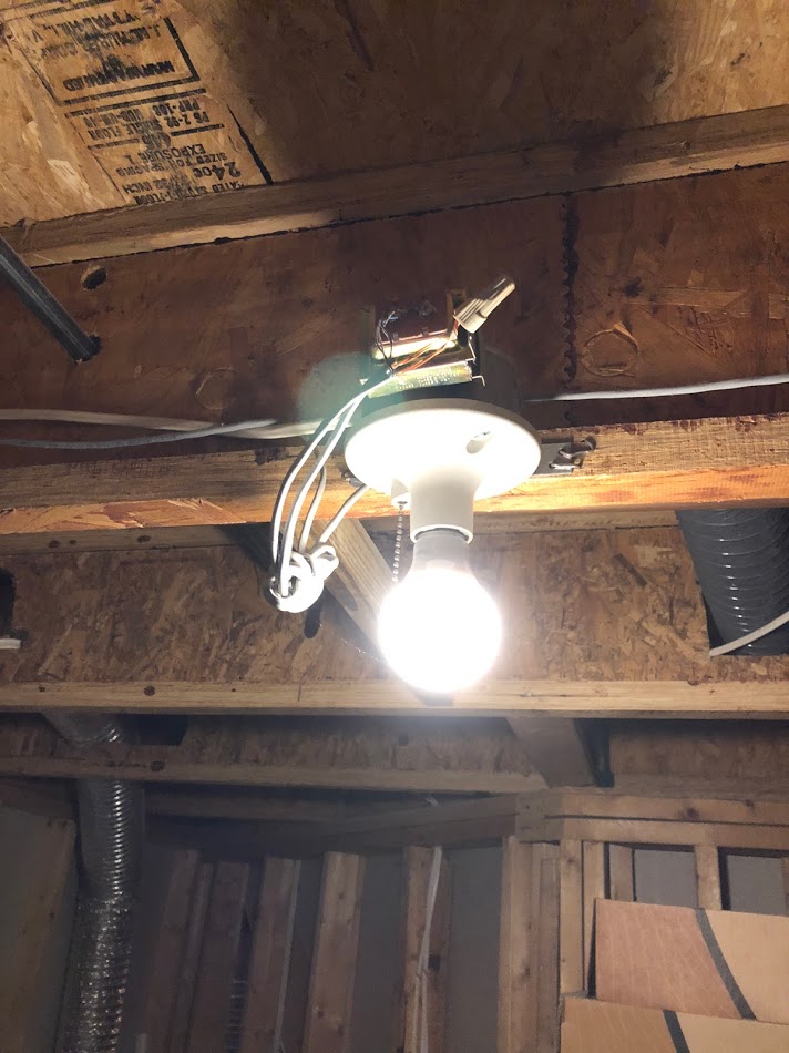

I love when I've lived somewhere for a while and come across something that I can't identify.
Could someone tell me what is attached to this light fixture in my furnace room? It's some sort of low gauge wire coming in from one side of the room, going into this block attached to the fixture, and then running out the other side of the room. It's clearly not the power for the light (that would be the white romex coming in from the left). It almost looks like ethernet, but it's certainly not that. I would google it, but I can't think of what to search for.
Anyone know?

Looks like a low voltage ac transformer for your house doorbell. One thin wire runs to the actual doorbell, the other to the push button near the front door.

Excellent question. There is one of those on the ceiling of my garage, it is near some ceiling lights exactly like the one pictured, and I want to know the same thing.
It’s possible I may have already asked this question here on the BBS and gotten an answer that I don’t remember.
It looks like a DC transformer but why would one be needed on our garage ceiling?
I vaguely remember either being told this or deciding this too.
Is there a chance that this thing could emit a low hum that's picked up by my pro audio gear during recording sessions? The floor of the studio is directly above the ceiling of the garage. And I've had an everpresent faint hum at approx 60 cycles that I keep having to deal with.

As others said, most likely the doorbell transformer. But possibly instead a transformer for powering a furnace humidifier (ugh!), or sometimes even an alarm system.
But most likely, for the doorbell(s).
As for 60Hz hum, the transformer itself will typically have an audible hum. So if that is audible in the recording room, then it might be picked up there.
But 60Hz electrical noise is also present in all of the home wiring, including the wiring powering the audio gear. And the most likely source of 60Hz in a recording is from the 60Hz electrical noise of that wiring.

Loosen one of the screws and carefully pull the wire(s) away from the screw, so the wire ends are just hanging in the air. Then go check for what doesn’t work anymore. Doorbell would be my guess but it could be something else that runs on low voltage.
When done, reconnect the wires under the screw head and snug the screw tight. If you do accidentally short wires or the tool between the two exposed screws there may be some sparks. While visually surprising, the mild sparking is not dangerous to you nor the transformer.
#370522 - 14/02/2018 15:27 Re: What is it? [Re: Dignan]
Thanks folks! I think you're right on the money about the doorbell. I took the button off once to see if I could re-route it for a Ring bell (my doorbell is on the side, unfortunately), and I seem to recall seeing what looked like cat5 connected to it. I looked a little closer last night and I actually think it's Cat3.
So that makes sense. I suspect that the wire going out to the right goes the button and the wire going to the left goes to the actual bell.
