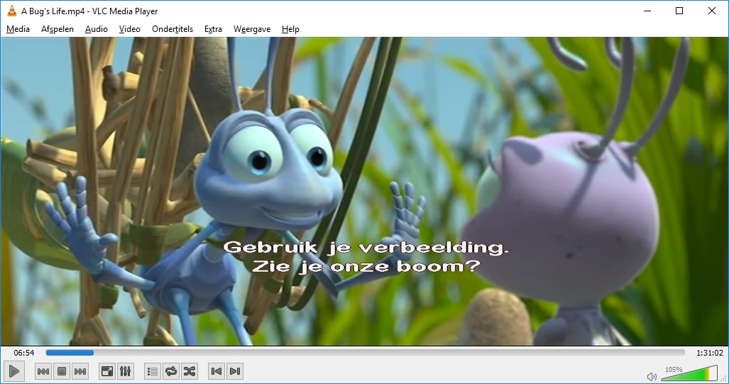

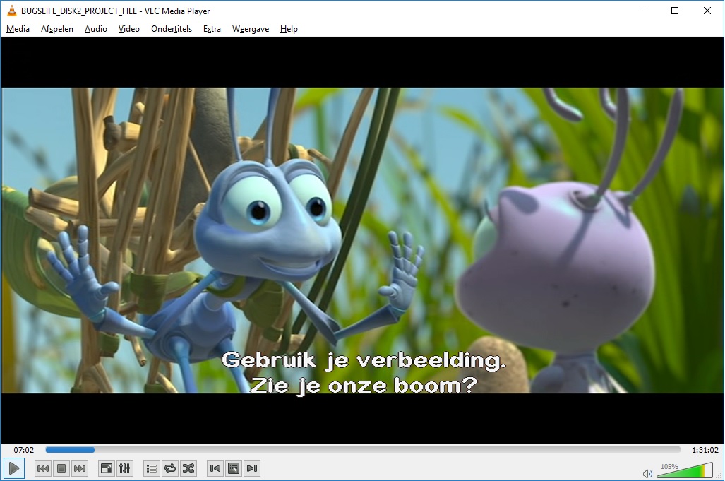

OK, I've made a couple of screenshots from the move "A Bug's Life", with Dutch subtitles. The first screenshot is from the .ISO file, straight from DVD. The second screenshot is what Handbrake makes of it, after conversion to MP4. You can see that, in the second screenshot, the subtitles are way too high.
Should anybody know how I can fix this, how I can lower the subtitles a bit, I'd be most grateful.
Subtitles are positioned relative to the bottom of the screen. On the DVD, the movie is letterboxed, so the subtitles are positioned "correctly" within the movie image. Once Handbrake crops the movie, the image fills the screen, so the subtitle position relative to the bottom of the screen means that they now appear in the middle of the screen. As far as I can tell, Handbrake does not provide any options to account for this during a crop. There's a post here with a workflow to solve this, but the referenced software -- DVDSubEdit -- appears to be pretty old.
The only other option (aside from patching Handbrake) is to have Handbrake use soft subtitles (i.e. don't burn them into the image). Then use VLC for playback, which lets you reposition subtitles.
But in his example, the subtitle position is terrible in both cases. Imagine if the film weren't letterboxed, let's say it was a 4:3 ratio video that was made for television. The subtitle position would be terrible even in that situation.
Yes, this. Definitely this.
... Or use just about any program, VLC or otherwise, for playback. I can't think of any decent movie playback engine these days which doesn't have subtitle support built in.

Those screen shots show that he is indeed using VLC for playback. What if he wasn't baking the subtitles into the video in the first place, and he merely needs to adjust the subtitle positioning in VLC?
Maybe this case isn't handbrake's problem at all.

No, I can tell that the letters are vertically squished in the lower screenshot due to the compensation for the letterboxing. They're baked in. Yeah, that's the root of the problem.
#369335 - 13/09/2017 21:12 Re: Handbrake and subtitles... [Re: tfabris]
You're right Tony. I just found out about this setting in Handbrake. If I uncheck it I can put multiple subtitles into one MP4 file as well, so that's bonus.
The subtitle location is still bad, but indeed, in VLC I can pretty easily move the subtitles lower. Which is what I will do.
