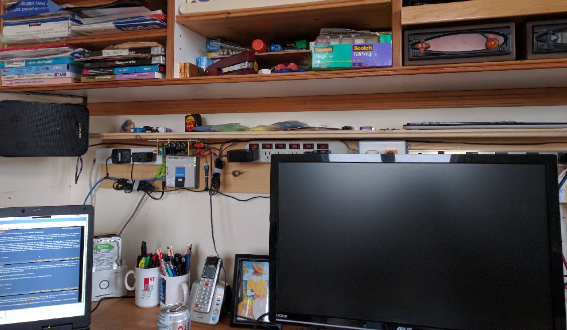

Exposed wiring an issue? Nah.. wink
One corner of my home office, with the "sound system".
Description: Amp near centre of photo.

Wall mounting small electronics stuff really does make a difference.
If I can avoid stacking electronic stuff on a shelf, or not even have a shelf, so much the better. Especially for gear that is not going to change in configuration very often.
I have been known to just poke screws straight into the drywall for equipment mounting, with nary a plastic plug, but a section of wall mounted plywood makes it easier to rejigger locations as needs evolve. I sometimes paint the board wall colour, if the opportunity arises.
Tucking the equipment inside a closet (perhaps with modest ventilatation), I will install an LED lighting strip so I can see what I am looking at when working in there. Which hopefully is not often.
#368594 - 07/04/2017 13:04 Re: Whole home audio [Re: K447]
I vertically mounted a bunch of fibreboard to the shelving rails in my study.
#368595 - 07/04/2017 14:00 Re: Whole home audio [Re: BartDG]
I have that strip of pine running 11' across the wall above the tables, with a small shelf affixed to the top of it for mice, keyboards, lens cloths, etc. The entire assembly uses just four screws into the studs, so fewer holes to patch next time the space is rearranged.

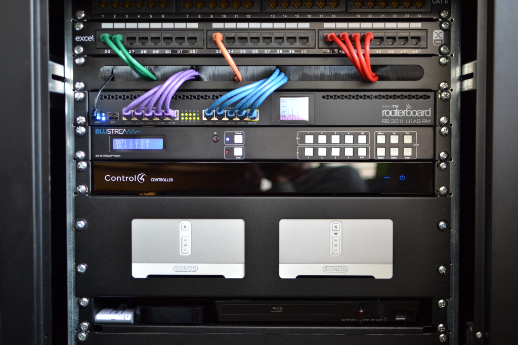

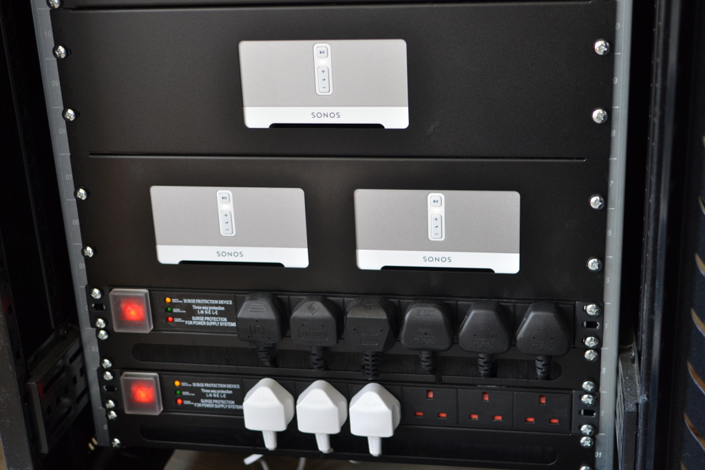

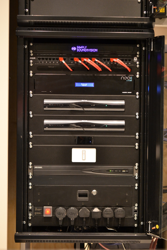

I do quite a lot of residential projects, working on everything from a couple of Connect:amps to huge Control4 systems.
There are rack mount solutions for SONOS products that work well, you can see some of these on this Instagram account: https://instagram.com/ssavprojects
A similar albeit higher end alternative is Bluesound. While it may look like a me too product, the proof really is in the sound quality.
If you do really like Chromecast Audio, take a look at the NAD CI 980 and CI 940. With one of each and six Chromecasts you would be done.

There are rack mount solutions for SONOS products that work well, you can see some of these on this Instagram account: https://instagram.com/ssavprojects[/url]
I'm sorry, but I wouldn't call that a rack mount solution. It's more like multiple Sonos units on a rack. smile
There are some freestyle solutions in there for specific locations, but if you keep scrolling you'll find some actual 19 inch rack solutions too.

Ah, didn't see those pics, thanks for that! However, I still don't think that's a true rack based solution, but I do agree it's nicely done. Probably the best somebody may expect with the limited options there are.
