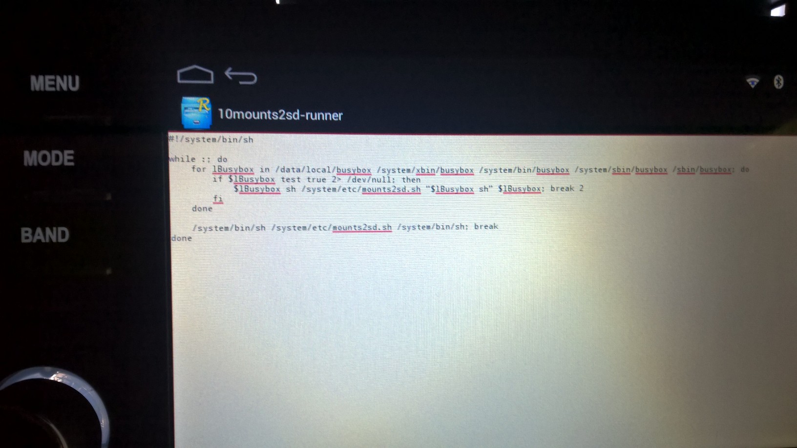

Mount2sd placed in /etc/init.d the script 10mounts2sd-runner. I am attaching a screenshot of what it does. In int, I saw a reference to a mount2sd.sh located in /system/etc , which I also guess was created by the app. I am attaching that too.

Gag. What the heck is that script doing in 1575 lines of code??? This is really a two liner: #!/system/bin/sh
mount /dev/mmcblk1p2 /data Maybe save the original script and replace it with the above two lines? EDIT: Wait: not sure about the exact path. The script uses _mount for everything, whereas the standard (Linux) command is mount (no underscore). Get it wrong, and your phone might not boot. Researching..
