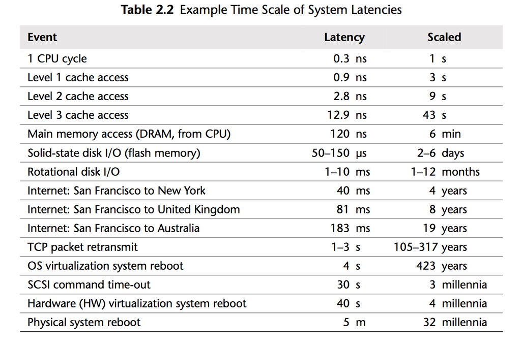

In all seriousness I'm curious why you're interested in larger SSDs. I'd prefer to save the cash by picking up a system drive for around $150 then spend another $150 for a 3-4TB disk drive for storing files.
Because paying for speed is worth it:
(I'd been meaning to find this sooner, it's a great illustration of why I want the data I work with on an SSD, not just system files.)
