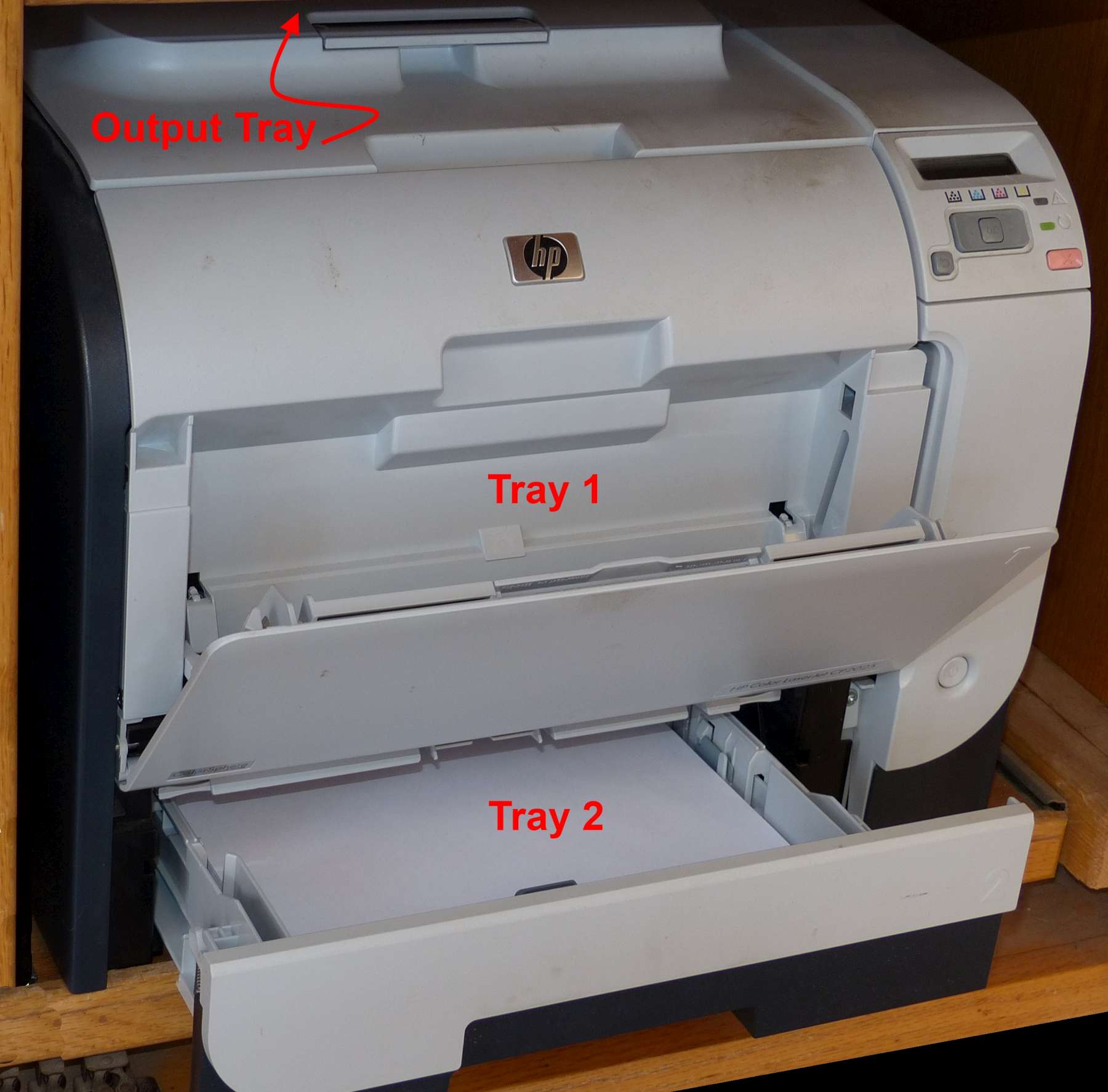

If I might hijack your thread just a little bit... below is a post I put on a DIY printer repair website. Chances are I'll get better response here.
My Hewlett Packard CP2025 will jam 90% of the time when printing multiple duplex pages. The problem is NOT in the duplexer.
It isn't even really a "jam" as such. The roller picks up the page and instead of feeding it into the rest of the printer, it drops it down underneath tray 2, and the status screen says "Paper jam in tray 2" or something similar.
The printer will print any number of NON-DUPLEX pages from TRAY 2 in without jamming.
It will always print a SINGLE DUPLEX page from TRAY 2 without jamming.
On rare occasions it will print TWO DUPLEX Pages from TRAY 2 before it jams.
It will print any number of DUPLEX pages pages from TRAY 1 without jamming.
Clearly the problem is not the pickup roller (the printer has <9,000 pages printed) because if I tell it not to duplex it doesn't jam.
Clearly the problem is not the duplexer because I can print duplex all day long as long as I feed from tray 1.
It seems to be some sort of timing error, since it will print a single duplexed page reliably from tray 2, but will fail 90% of the time on the second page.
Any ideas?
At the present time, I work around the problem by printing from tray 1 if I have multiple pages to print duplex. Nonetheless, I'd like to fix the problem.

You could theoretically see if there's a firmware update to the printer available.
The printer worked well (no duplexing jams) for the first couple of years I had it. This is new behavior from the same old firmware.
paper path of the printer,
Tray 2 (the problem tray) sits at the bottom of the printer, slides out like a dresser drawer to replenish paper. The paper is picked up from tray 2, goes up the back side of the printer around the print drum, then through the fuser to fix the toner, then if duplexing is set it goes most of the way into the output tray then gets sucked back through the duplexer and around the drum to print the back side of the page, through the fuser again, and finishes in the output tray.
something that is only needed when you're feeding a page into the duplexer from tray2.
That's the puzzling part. The paper is only fed to the duplexer at the end of the process, after it has gone through the drum and the fuser, long after it has left the tray. Oh, wait...
The first page is picked up, goes through drum, fuser, duplexer, back to the drum and fuser for the second side, and the next page is being picked up before this process is finished -- probably about the time the second side of the first page is going through the fuser. This is true for non-duplex printing as well, but with duplexing there is the delay while the second side is being printed before the next page is picked up. It is different logic for the paper handling, not to mention a different path.
parts are well seated, for example that the duplexing assembly is fully seated and attached well to the rest of the printer.
I don't think that's it, because if the paper makes it out of the tray and onto the print drum, the duplexer itself is 100% reliable. Tray-->Drum-->Fuser-->Duplexer-->Drum-->Fuser-->Output Tray.
Originally Posted By: trabris
If Tray1 and Tray2 are interchangeable
Tray 1 tilts out from the front of the printer (see photo) and is much lower capacity, meant for single sheet feeding, envelopes, card stock (the turns in the paper path are less acute), etc. From the time the paper starts up the back of the printer towards the print drum, the paper path is the same; it's only the initial pickup that differs.
I think you have put your finger on it. When the different logic is activated for duplexing, the pick roller is picking the paper out of the tray, but the feed/registration rollers are not activating to pull the paper into the printer during the time in which the previous page is still wending its way through the fuser and into the output tray.
Unless this is a known problem that other people have figured out how to fix, I don't think there's much I can do about it. At least I still have tray 1.

1) The problem occurs at Tray 2, long before the paper ever gets near the duplexer.
2) Printing a single page duplexed from Tray 2 is virtually 100% reliable, so the hardware is happy with the paper orientation.
3) Printing multiple pages non-duplexed from Tray 2 is virtually 100% reliable, affirming that the hardware is happy with the paper orientation.
4) Printing multiple duplexed pages from Tray 1 is virtually 100% reliable, further affirming that the hardware is happy with the paper orientation.
5) The only failure mode is on the second page of multi-page duplexing from Tray 2, and the point of failure is at Tray 2. That failure rate is at least 90%. The pick roller successfully lifts the page from the tray, but it appears that the feed/registration rollers are either failing to start the second stage of the transfer process, or possibly starting too late as the picked page just slides back down and ends up sitting on the table under the tray.
There is no jam, no need to open panels and pull crumpled paper out of the fuser. All I have to do is press the "OK" button and the printer re-initializes, successfully prints the failed page, then "jams" (I guess "misprints" is a better word) on the following page.
It really, really looks like an electronic problem where after the pick roller pulls the paper out of Tray 2 the feed/registration system either isn't starting up or perhaps starts too late, but only on the second [or rarely, third] page of a multi-page duplexing job.
Out of Tray 1, everything works reliably regardless of configuration, i.e, single/multiple, duplexed or not, or any combination thereof. Puzzling, though, is that both Tray 1 and Tray 2 share the same set of feed/registration rollers...

Whether or not duplexing is selected for Tray 2, the printer uses exactly the same rollers, from pick roller through feed/registration roller through transfer roller, through the four drums and the fuser, and finally the output tray.
With duplexing selected, the first page prints duplexed very reliably; then the pick roller grabs the next sheet of paper out of the tray, takes it to the feed/registration roller which apparently doesn't activate, because the paper drops onto the table under the printer, where it can be picked up and re-used. Note that the failure occurs long before the paper ever gets to the duplexer, in fact long before the paper goes anywhere.
With duplexing NOT selected, the pick roller grabs the paper out of the tray, takes it to the feed/registration roller which happily takes it and feeds it through the rest of the process with virtually 100% reliability. According to the status page, there have only been four actual paper jams in all the time I have had the printer. That's 99.97% reliability.
A 100 page print run will operate flawlessly with duplexing NOT selected. A 2-page print run will fail at least 90% of the time when duplexing IS selected, yet the failure has nothing to do with the actual physical duplexing process. I think it's a timing thing. While duplexing, there has to be a delay before the second and subsequent pages are picked up to allow for the extra time needed for the first page to complete its pass through the duplexer. Either the pick roller is picking the next page up too soon and the feed/registration roller isn't ready for it, or else the pick roller is right on time and the feed/registration roller doesn't activate.
Since Tray 1 has its own pick roller but uses the same feed/registration roller as Tray 2, I suspect that the problem is early pick on Tray 2 because Tray 1 will duplex all day long without any problems.

I don't think it is a mechanical problem at all.
The thing that is different when duplexing is there has to be a delay (compared to non-duplex printing) in picking up the next sheet of paper while the back side of the page currently being processed is printed. This delay has to be coordinated between the pick roller and the feed/registration roller.
It appears that either the pick roller is not waiting through the delay period and sending the paper to the feed/registration roller before it is ready for it, or else the feed/registration roller is not getting the signal to take the page from the pick roller.
Because Tray 1 and Tray 2 both use the same feed/registration roller, and Tray 1 duplexes properly while Tray 2 doesn't, I would suspect the problem lies with the Tray 2 pick roller sending the paper to the feed/registration roller too soon.
This suggests a logic failure, perhaps a corrupted driver or firmware. It is a long shot, but I will download and reinstall the printer driver and see what happens. I'm not optimistic that it will solve the problem.
