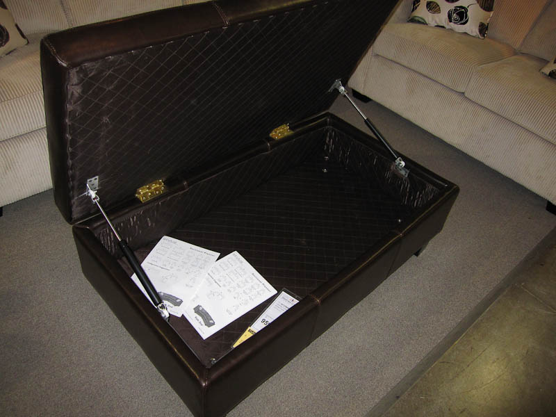

Engineering/Mechanics lever questions/calculations.
This is in relation to something I mentioned in another thread, specifically about a storage ottoman I've designed and built. It's a large piece and in addition to hinges it must feature gas springs to help the user lift the top as well as keep it open. At the moment I'm trying to figure out which gas lifts/springs to buy and have a choice of a number of parts each with a rated force/lift capacity. Since the lifts will attach closer to the pivot or fulcrum point of the lid, I expect there to be a mechanical disadvantage, which I'd like to calculate. And seeing as I don't envision a career in applied mechanics, nor have I really any background in it, I'm hoping someone can help me through this if I provide a few numbers and measurements. With a quick peek at wikipedia, I believe a hinged top is most similar to a class 3 lever, one which the force applied sits between the pivot and the load. Although in this specific case the load is really the weight of the entire lever (lid) itself, not at additional object at the end (front) of the lever. Here's an image of the ottoman frame with measurements. The most important one (from that image) is the distance from the pivot to the front of the top, which is 31" (the width of the ottoman frame).  The top weighs 26 lbs currently - that's without foam and upholstery. Maybe we can run two sets of calculations and make the second set with the weight at 30lbs Now I suppose the missing piece of information is the force point. That's currently to be decided and it has to be derived from the lengths of the gas lifts available and the desired angle of the lid at its most open position. I'm going to make a few sketches in the morning to show how this fits together and to try and decide on the force point. I've also got a photo of a commercial ottoman (smaller) with similar gas lifts in place. I may have to try a few different variations which will determine if the lift is applying any usable force in the closed position or not (greater assistance when opening from the closed position). Here's a PDF from a manufacturer of gas springs showing some calculations: http://www.acecontrols.com/PDF/Gas%20Spring%20Catalog-Revised%2005-2009.pdf

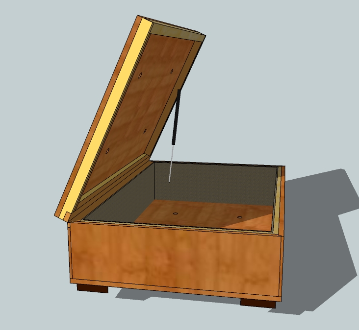

Ok, let's get back into it.  Sorry, but I've been a bit busy with my other construction projects and didn't get the images off my camera. The diagrams on the McMaster Carr site seem to orient the lift in the most sensible orientation. As you can see below, in this commercial Ottoman, not only did the install orient the lifts upside down (chamber down, piston up), but the install is also "rough" looking. The lifts are installed in a sort of backwards configuration compared to the illustrations and definitely don't aid at all in the first few inches when opening the top. This also means the top can slam shut in the last few inches. Maybe even a full foot. Not too good when concerned about little fingers. Incidentally, my ottoman should look a *lot* better than this unit when it's been upholstered and fitted with hardware.
Edited by hybrid8 (11/05/2010 22:55)

I'd like the top to open to 65 degrees which I've shown in the model below This is probably a dumb idea, and certainly not as elegant as what you intend... but as far as figuring out where the lift attachment points should be, could you make multiple pivot points like in the attached drawing and just use the ones that work best? tanstaafl.

I could make the multiple attachment points. But I still need to figure out one thing ahead of time.... Which lifts to buy.  In choosing those I need the right combination of compressed and extended length and force.

Now you're into trigonometry.
Basically, you have two triangles. Let's call them ABC and ABC' where A is the point described by the hinge, B is the point where the spring attaches to the box, C is the point where the spring attaches to the lid when it's open, and C' is the point where the spring attaches to the lid when it's closed. There's also a line AA' that is parallel to the ground and (obviously) passes through A.
Data points you can define are the angles CAA' and C'AA', and the ratio between the lengths AC and AC' (probably 1:1, though it seems like there might be some possibilities for it to be different).
Limitations are the maximum and minimum lengths of BC and BC'.
I've attached a GeoGebra doc that should let you play around with it. The blue point below the x-axis is free. You can move it around and see what effect it has on the angles and distances. (The point names in the doc are not the same as the point names I described above.)
