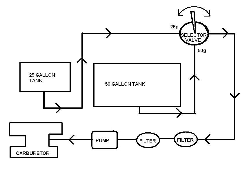

I need some solid information about vapor lock in an automobile fuel line.
When I moved down from Alaska, I brought all of my belongings in a 38 year old school bus that I bought for $1.00. (When I finished getting it roadworthy I had spent so much money that I made the guy who sold it to me give me half of my money back!) The bus has a 360 cubic inch Dodge V-8 engine feeding through a single two-barrel carburetor. It has a five speed transmission with a two speed rear axle, and in low gear/low range it would drive straight up a wall if it had enough traction. (Less than walking pace at 2000 RPM)
The bus has a complex fuel system -- dual tanks (25 gallon & 50 gallon) running to a selector valve, and then through two in-line filters and an electric fuel pump to the carburetor. (See diagram.)
If I drive the bus in warm weather (65 degrees or warmer) under load at speeds slower than 20 MPH, it vapor locks and quits. I have about 20 seconds warning that this is happening as the fuel pump is mounted under the floorboards and I can hear it starting to go "thocka-thocka-thocka" when it tries to pump vapor and I have until the float bowl in the carburetor empties to get the bus off the road. Opening the hood and letting excess heat escape for 10-15 minutes makes it work again. The engine is not over-heating; only the fuel system is too hot.
It was always my understanding that vapor lock could only occur on the input side of the fuel pump; that the pump couldn't pump gasoline "steam" and the fuel flow stopped; but that if the fuel were boiling in the output line between the pump and the carburetor the pump would keep pressure in the line and maintain fuel flow even if some of it were boiling.
I am beginning to wonder if this is a misunderstanding on my part.
The fuel lines are well away from any heat source, from the fuel tanks all the way through the selector valve, fuel filters, and fuel pump. From the pump to the carburetor is a different story -- the steel line is uncomfortably close to the exhaust manifold and exhaust pipe. Logically that is the most likely place for the fuel to boil. Arguing against that is the line should be pressurized, and usually when it vapor locks it is during a high fuel flow situation (crawling up a steep hill at maximum throttle in third gear low range at 15-20 MPH) so the fuel shouldn't spend enough time in the hot fuel line to boil. Also arguing against the boiling being on the output side of the pump is the fact that the pump is going "thocka-thocka-thocka" which strongly suggests that it is not receiving fuel from the input side. But the input side is not subject to much heat...
So, I don't know what is going on. Symptoms point to vapor lock on the input; logic points to vapor lock on the output side; [possibly faulty] knowledge says output side vapor lock shouldn't happen.

It's those 2 filters in the pump suction. What you've got going on has more to do with vapor pressure than heat. Prior to the fuel pump, you should only have a strainer, which is usually integral to the pickup line in the tank. Paper filters are high pressure drop items and should be in the pump discharge. One in the suction line and you'll probably get vapor lock. Two and you'll have it for sure.

Another thing you might want to check is if you are getting ANY restriction on the input side. If so the sucking of the pump will lower the pressure of the fuel. As you probably know lowering the pressure of a liquid causes it to boil at a much lower temperature. Another reason why most cars have in-tank fuel pumps.
Another possibility is that your pump is going bad. It may be generating its own heat and causing the gas to boil internally.
You might temporarily run a rubber fuel line from the inlet on the fuel pump to a gas can sitting in the bus (make sure it's not going to fall over) and then go for a ride on a hot day. That will at least rule out the input system.

Correct, just the one electric pump. The pump is new (replaced before leaving Alaska) and the fuel system was gone through thoroughly before leaving, to the point of pulling and steam cleaning the inside of the fuel tanks and under anything other than low speed high workload situations (climbing a long steep hill) everything works properly.
I know why this causes vapor lock (lots of heat generated by the engine working hard coupled with lack of airflow to dissipate the heat due to low vehicle speed) but what I really need to know is this: Is the vapor lock on the output side of the fuel pump where all the heat is, or on the input side of the pump where there is little heat but which I had understood to be the only place vapor lock could occur?

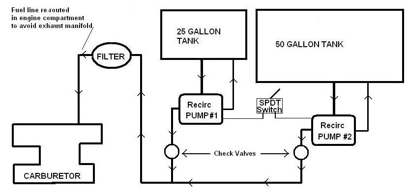

Perhaps a fuel system upgrade is in order--replace the fuel pump with a recirculating pump, the kind that recirculates back to the fuel tank the fuel that doesn't go to the carburetor so that there is always cool fuel in the lines. But this is complicated by the dual tank setup; I'd have to choose one tank or the other as the default recipient of the recirculated fuel. This could work very badly if both tanks were full and I was taking fuel out of the non-recirculated tank.
Hmmm... this gets me to thinking. How about a simplification of the whole system, like the attached? OK, it's not a simplification, is it? I get rid of one component (switching valve) and add a bunch of other things, but as a scatter-gun approach to solving the problem it ought to be sure-fire. I like the fuel pump redundancy idea, too. If one pump fails, I can continue on the other one. Center-off position on the SPDT switch also gives me theft protection, because God knows, the car thieves are out in force looking for 1971 school buses! smile
Are the check valves necessary, or are they built into the pump(s)? I don't want fuel recirculating to any tank other than the one that fuel is coming out of in order to prevent overflow in a full tank.
One problem I foresee is finding someone to do the work. Most mechanics are reluctant to work on fuel tanks, particularly if welding is involved, and I think there would be welding required to install the return line fittings to the tank. Are there any magic fuel-resistant epoxy adhesives that would work? I've used a fuel tank leak repair epoxy that worked for years after the repair. Could I drill a hole in the tank, thread a fitting into the hole and then gloop the hell out of it with epoxy? [Gloop = mechanic's technical term]

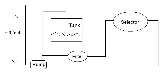

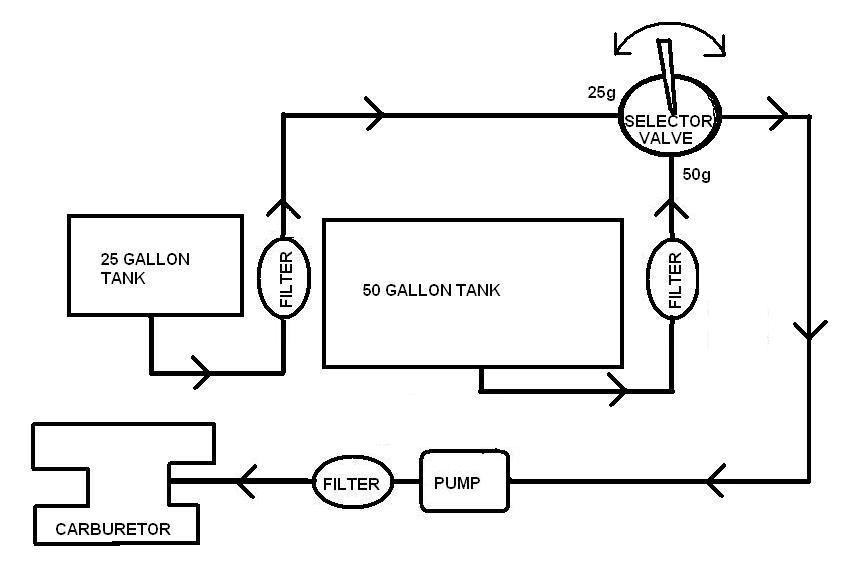

I went out to the storage yard and climbed under my school bus to be sure that the fuel flow path was as I remembered. It almost was. I've attached a modified diagram to show the differences. Essentially, the two fuel filters are between each tank and the selector valve, rather than in series after the selector. That will alleviate some of the problem - the fuel on the intake side of the pump only goes through one filter instead of two. I also found a filter on the output side of the pump, and there is a fuel strainer attached to the intake of the pump.
So, while the fuel only goes through one filter on the way to the pump, there is another aspect to the fuel path that will make things worse. Maybe. The fuel pickup is (obviously) in the bottom of the tank. But the fuel exits from the top of the tank, so there is about a two foot elevation gain. From there the fuel line loops back down to about a foot below the bottom of the tank to the fuel filter, then goes back up about three feet to the selector valve before coming back down to the fuel pump. Hey - don't blame me, I didn't design this! In the normal course of events, these elevation changes wouldn't matter, there is a net elevation loss between the fuel pickup and the pump so fuel would flow to the pump through siphon action even if the pump were not developing suction. But in our case, where the vacuum in the lines may drop the line pressure to the point that the gasoline boils, the siphon may break. I'm not sure about this. Maybe the ups and downs are irrelevant. I've attached a drawing more or less to scale showing the vertical travel of the fuel on the way to the engine.

I'm thinking the elevation changes are no big deal, it's only the length of line that will cause friction, and gas in a carb setup doesn't move fast, so essentially no friction loss.
You mentioned clear plastic filters. Are these tiny? The ones that were clear that I remember are. A good fuel filter should be about 2" dia x 4" long (just swag numbers here). Can you take a pic of them?
That fuel strainer is all you need on the suction side.
Filters are maybe 1.5" diameter, 2.5" long. Not tiny, not what I would call full-size either. Pictures are difficult as the bus is parked in storage a good bit away from me.
