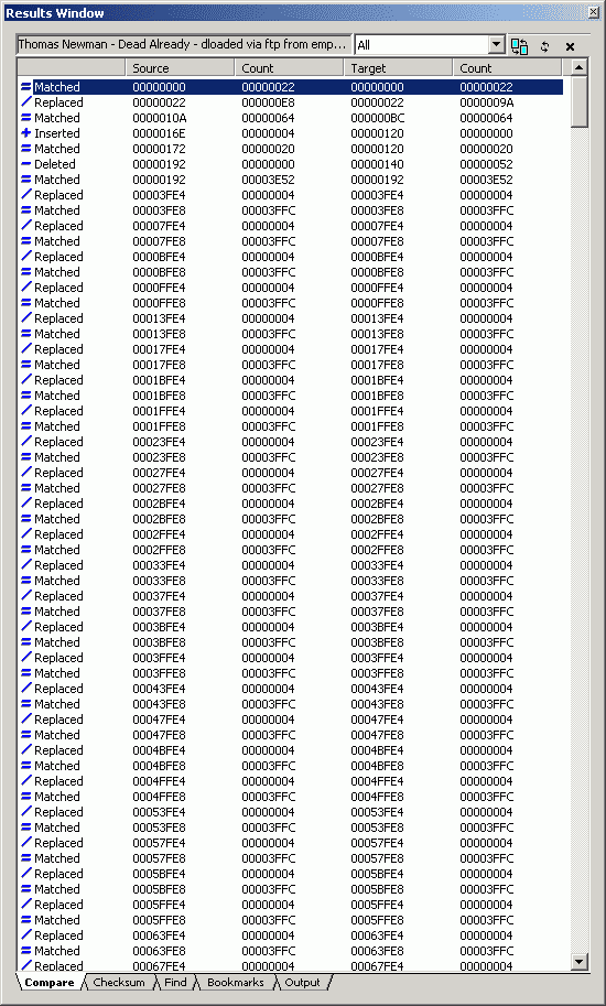

Empeg web interface in theory allows downloads, but it does not seem to work on any browser here. However, I downloaded the fid via ftp. on www.ilquen.it/download you can find a mp3 which gets skipped regularly by the ipod, and it's empeg version which works well on the empeg: i downloaded via ftp and hopefully did not damage it.

Ok. So yeah the tags are different somehow. Looking at the Thomas Newman track basically 4 bytes are replaced with zeroes every 16kB. So the tracks were the same and from the same encoder before getting corrupted at least
Possbily whatever created the new tag with "Taym's Grab & Encode" has also munged the file?
