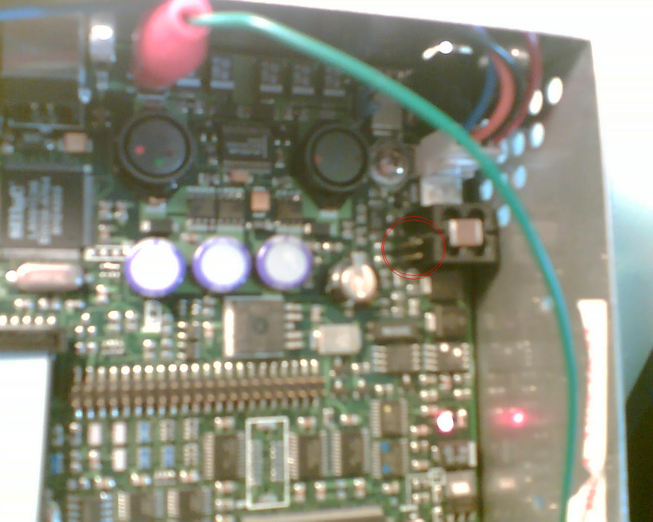

sorry for asking, but how do i most easy fix a temp sensor that is showing 0 degress ccentigrade even that it's 20 degrees ?
can i get around it without the soldering iron?

i did the fix with no problems, but how do i change the corrected temp in hijack? can that only be done in the real hijack and not the special one used when fixing the sensor?

btw.. there is a jumper located just in front of the power connector.. does any know what it is for?
I believe it was intended for a factory fan, but isn't really useful as such (constant voltage, no s/w control, ..).

the sensor says 28 degrees centigrade, but an external termometer says 25,5 to 26,1
is it normal to be off like that?

just re soldered pin 8.. now the temp is precise
