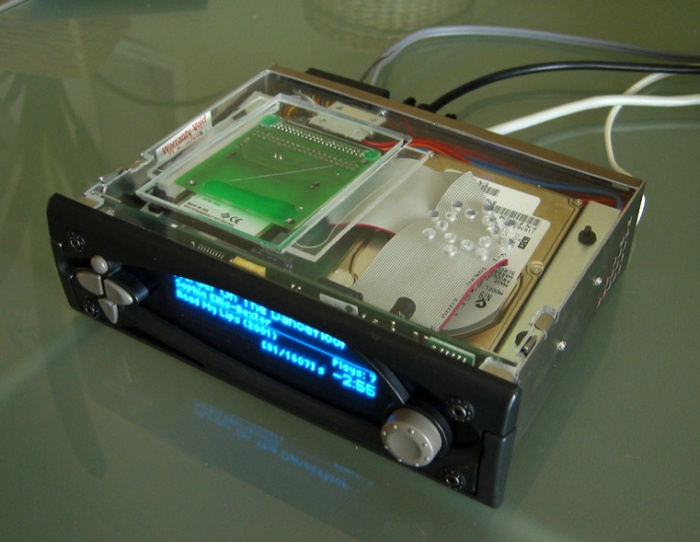

#317241 - 11/12/2008 04:24 Re: Compact Flash empeg with easily removable cards ? [Re: crazyplums]
FireFox31
Registered: 19/09/2002
Posts: 2494
Loc: East Coast, USA
The coolest CF empeg mod I've seen is shown in the attached photo. Trick is, it's from over 4 years ago; 10/6/04. Someone's been at this CF mod for quite a while now. Image credits go to kildal.dk.
Yup, it's a plexiglass top with a hinged door that has the CF slot mounted to it. The slot is mounted with the pins facing backward so it's easy to pull the card straight out.
Hm, CF could be a convenient way to get podcasts onto the empeg, if only there were the appropriate tools for Windows.
