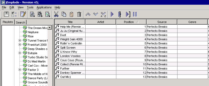

Missing as in the tunes aren't showing any of the artist tags (which I know are there..) check out the screen shots -

Jemplode screen shot -
172296-screen shot_jemplode.jpg (237 downloads)
http://mvgals.net - clublife, revisited.

Emplode -
Same record, JEmplode -

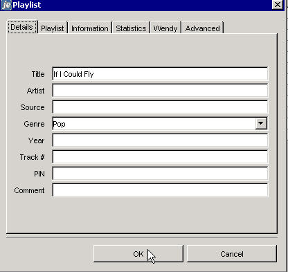

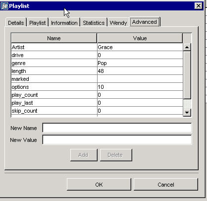

advanced tab (they show here..)
#173531 - 04/08/2003 20:38 Re: jemplode (missing) artist tag? [Re: dionysus]
dionysus
Registered: 16/06/1999
Posts: 1222
Loc: San Francisco, CA
Detailed tab - do not show up here...
advanced tab - they show up here...

Found the problem.. It seems to be a simple capatilization thing.. If I add an artist (lower case) in the advanced tab and a corresponding key value, it shows up; but all the Artist key in my songs are Capitalized...
Legacy empeg upgrade where they changed the case, maybe? anyway to get the jemplode software to see 'Artist' as being the same as 'artist' ?
