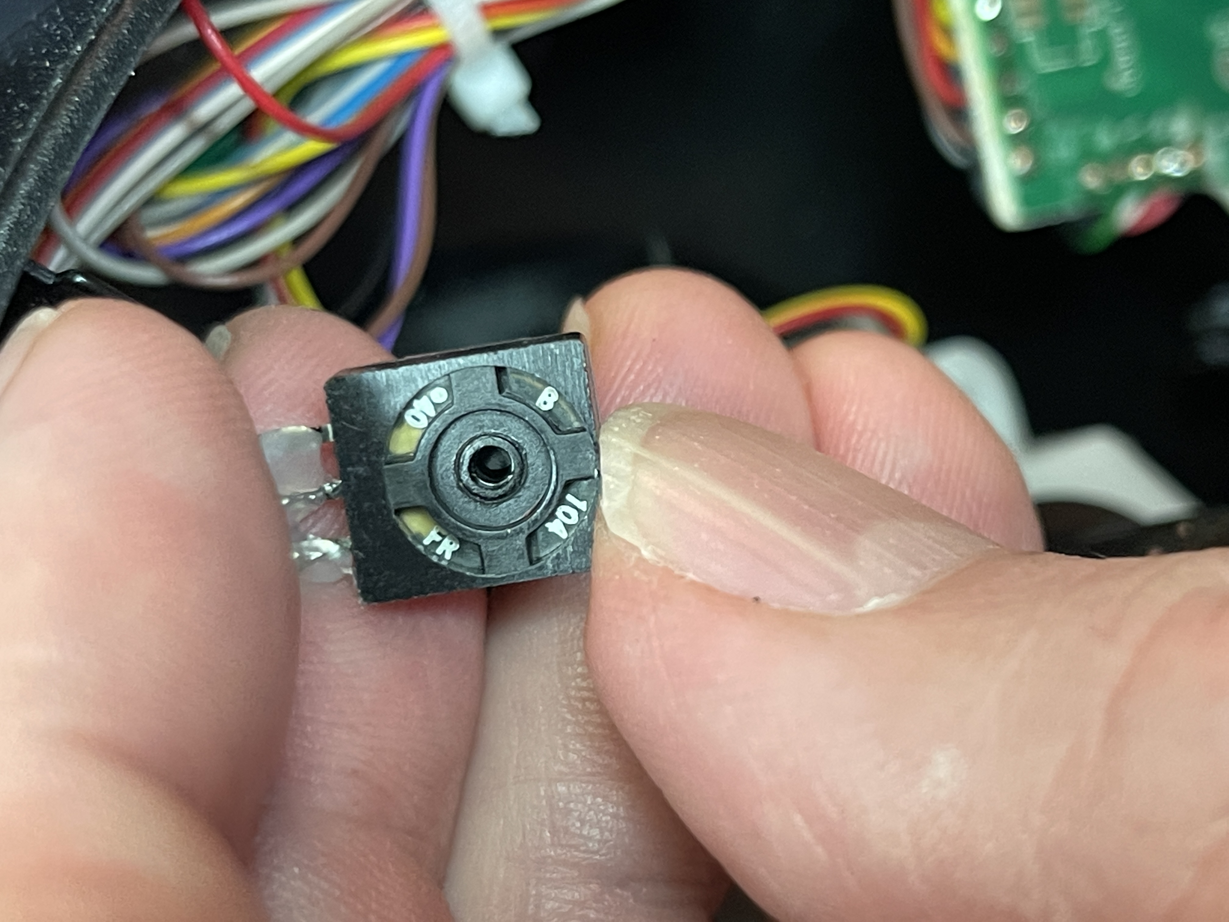

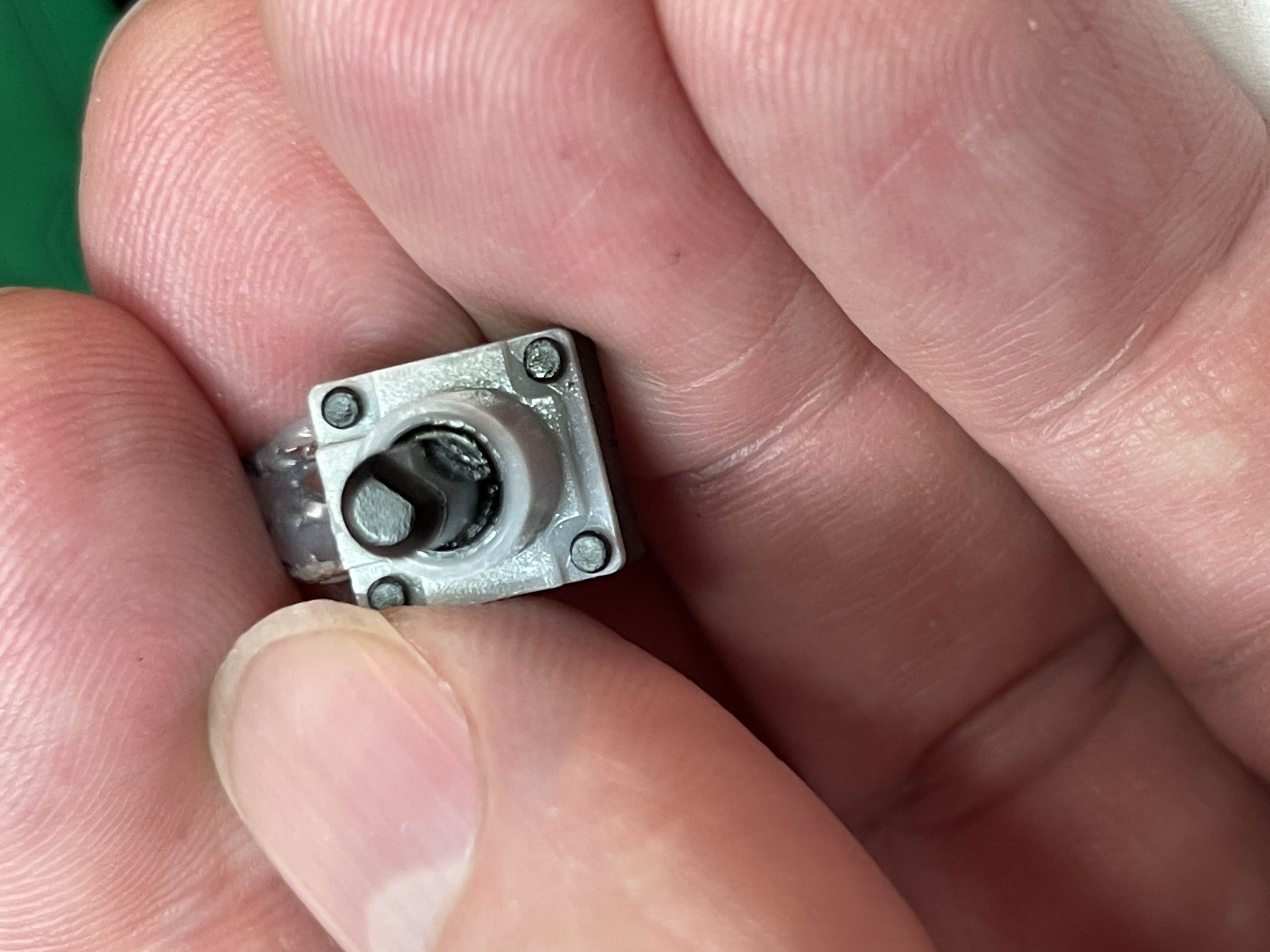

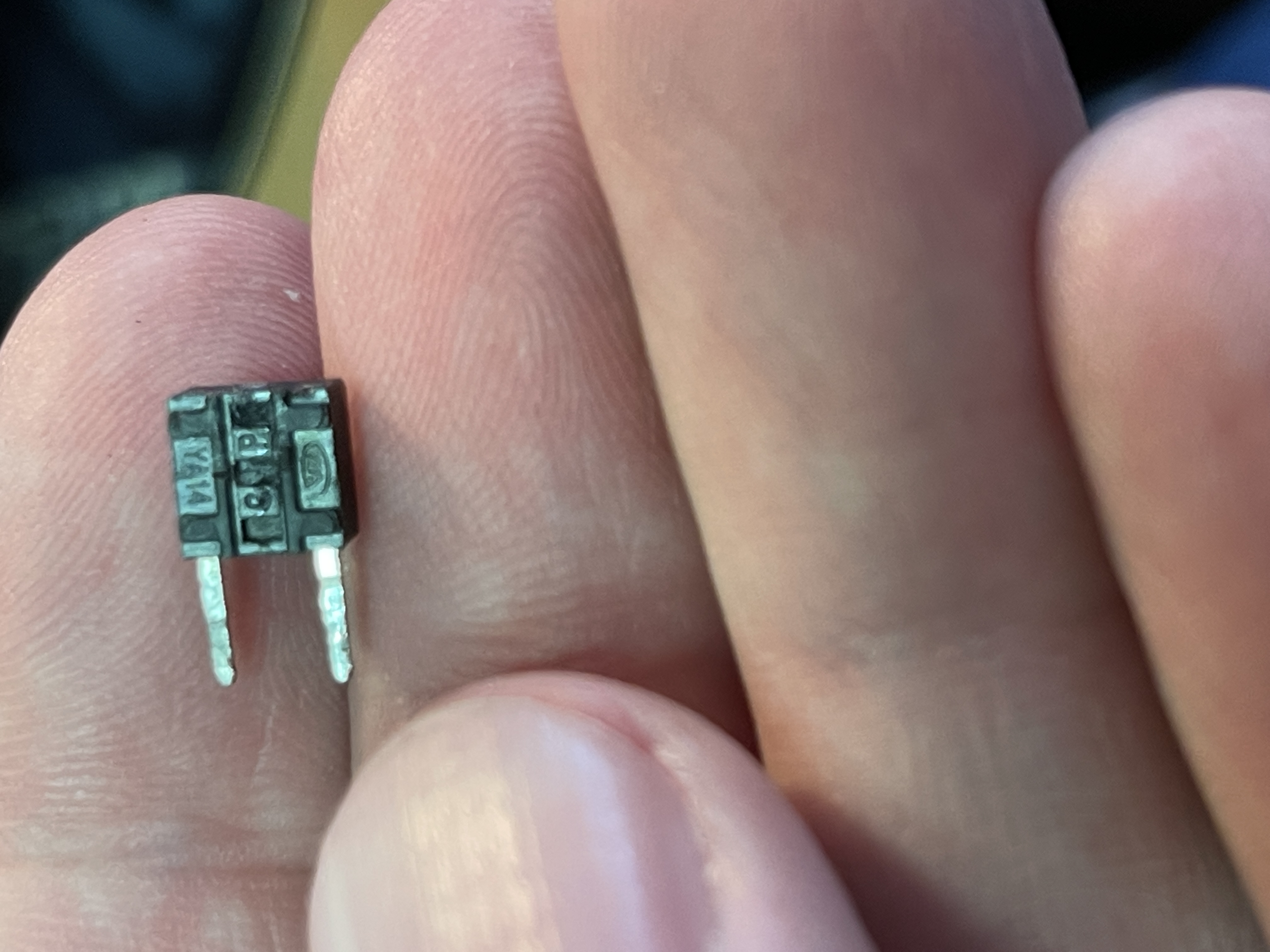

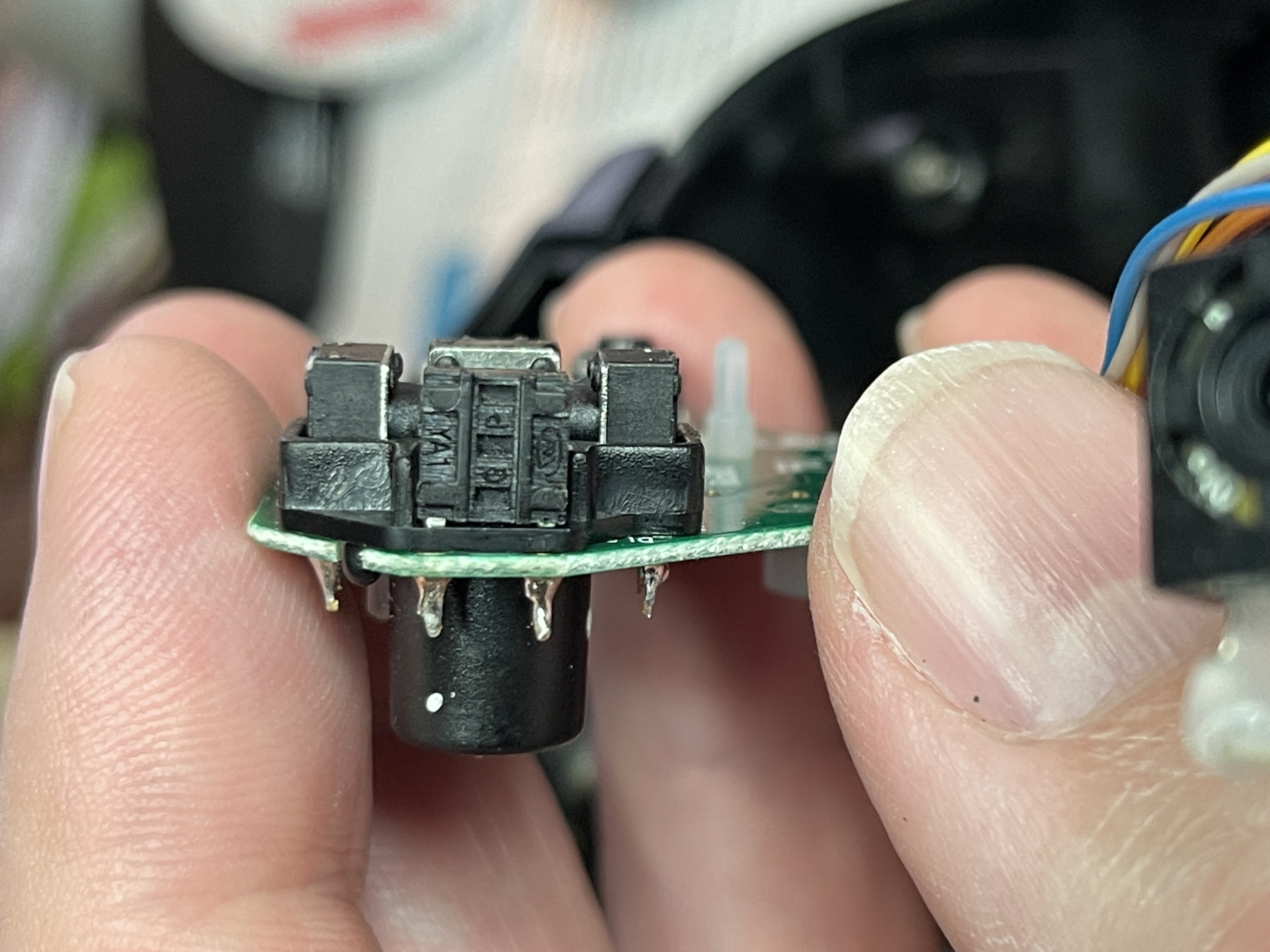

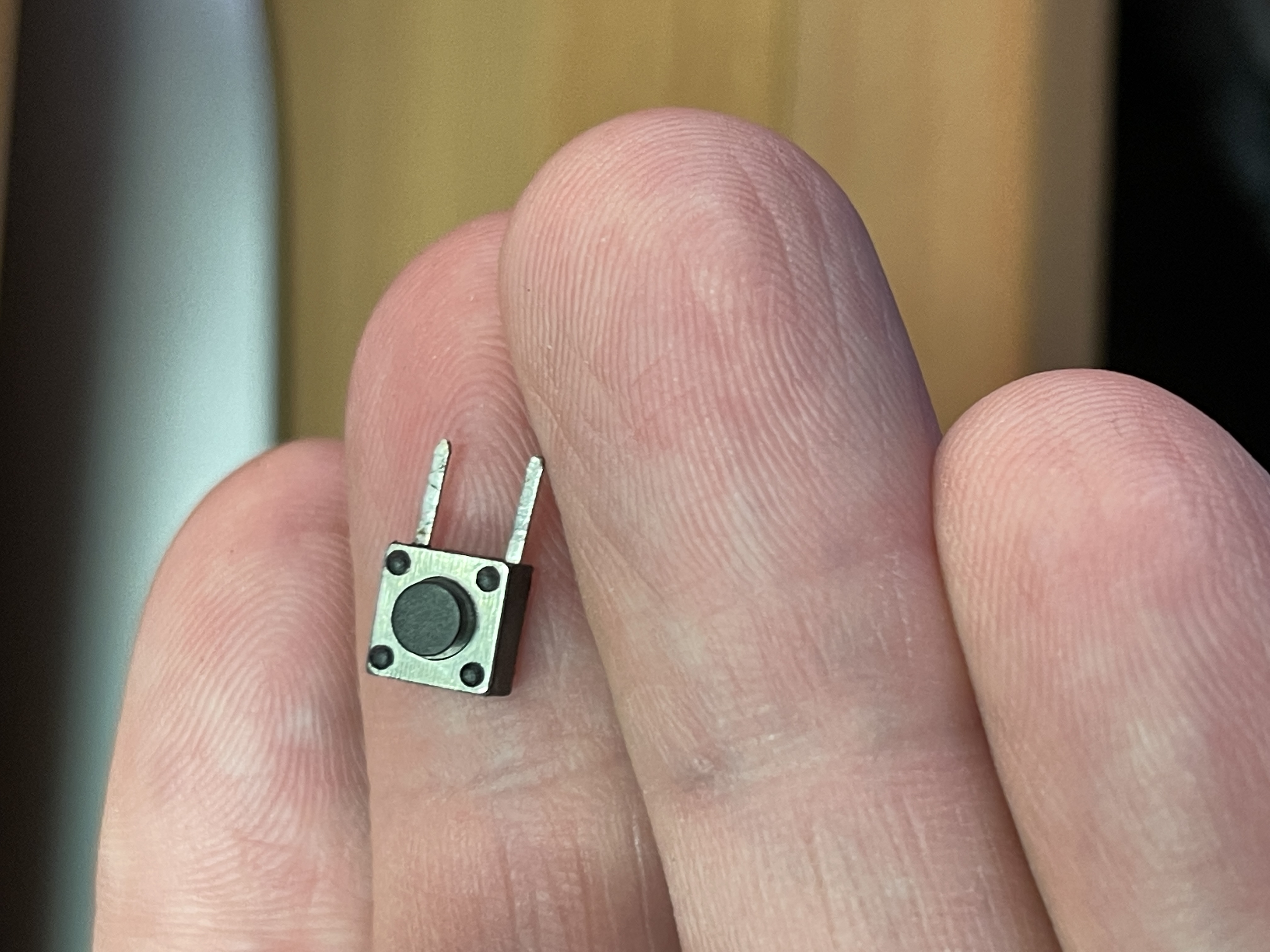

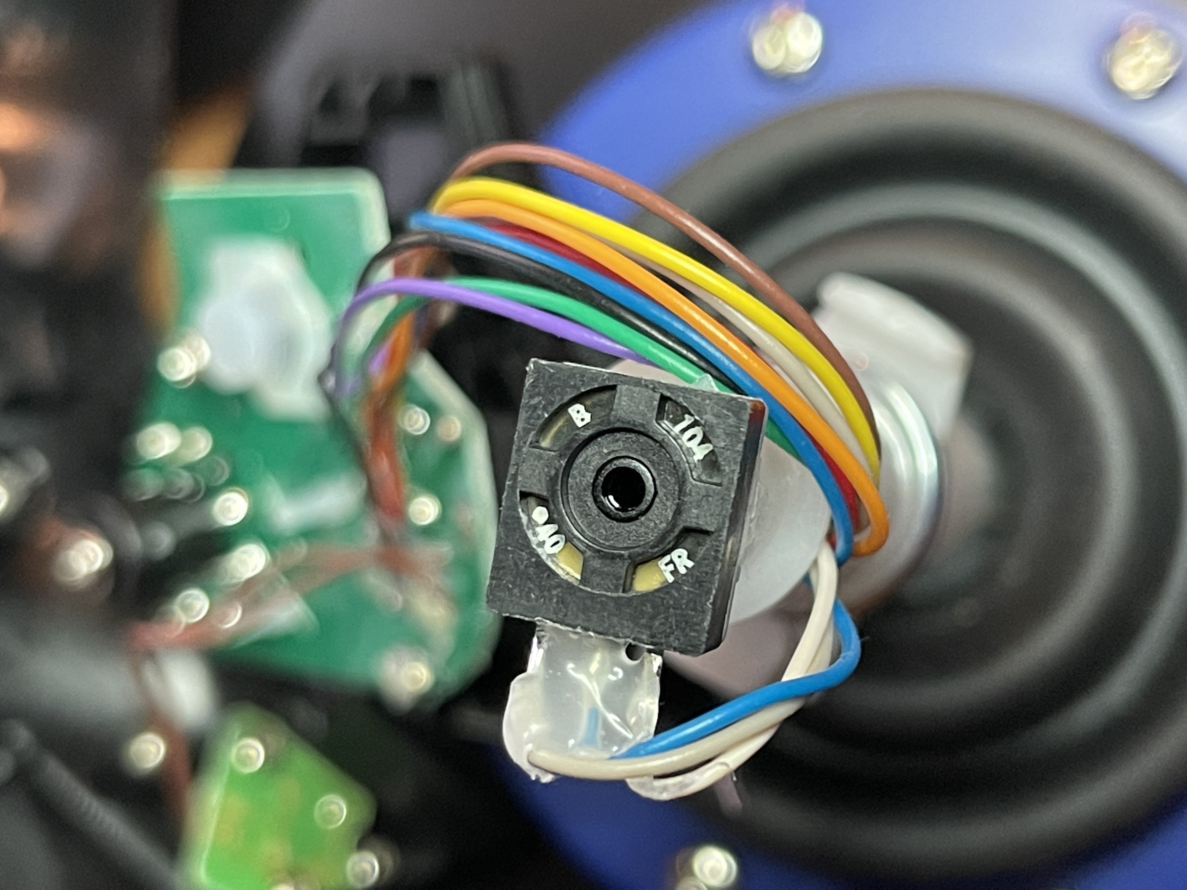

I'd like to find Digikey ordering numbers for these guys, to order replacements, but my searches there aren't working, nothing is coming up which looks anything like what I've got here. Anyone know how to ID these? Photos attached.
These are parts from a joystick, Thrustmaster T-Flight HOTAS 4 model. The pots are for X/Y axis and the rudder rotation axis, and the switches are for the 4-way thumb-hatswitch.
Switches are temporary pushbuttons with a sort of a "click" to them when they are pressed. Potentiometers have a limited rotation travel range of about 270 degrees total, though I don't have an easy way to measure that accurately to be sure. I'm hoping that the printed codes on there are some kind of a clue to their detailed specs.

These switches are similar, but not identical:
https://www.digikey.ca/en/products/detail/judco-manufacturing-inc/50-0014-00/307996
https://www.digikey.ca/en/products/detail/cw-industries/GPTS203212B/3190592
On Digikey, I searched for Switches -> Pushbutton Switches and then filtered with Mounting Type (Through Hole; Right Angle) and Circuit (SPST).

For the pots, more info would be required to find a suitable match. Eg. the overall resistance (10K-Ohm?), whether it is linear (most likely) or logarithmic.
With that info, a Digikey search should be possible. They don't carry everything though.

For the pot, the B104 tells you it's a linear taper 100K.
Here's a similar pot that would probably work:
https://www.digikey.com/en/products/deta...pQFgBkACEAXQF8g
This part number is for the shaft with the flat, although the picture doesn't show that.

Mark, thanks for the switch links. Theoretically any momentary SPST switch will work as long as it's the same dimensions, so that is very useful.
I dismantled my troublesome switch under magnification, and it was a normal dome switch on the inside. It looked like it was manufactured with poor QC, and there was a lot of blackness on the dome and the contact points, as if the black plastic had outgassed or "bled" during the manufacturing. Cleaning it with isopropyl and re-assembling has made it work fine again, but I intend to order more replacement switches just so I have more on-hand so that future repairs are easier.

Larry, thanks so much for the ID of the pot. I was indeed hoping that the numbers printed on it would indicate its specifications. Where can I find a reference source for how to read those identification numbers? Some googling gets me a lot of links for guitar amps, and the larger pots in those amps seem to use different types of coding numbers. For example, though I see that "B" means linear taper, I don't see how "104" indicates 100K?
Thanks so much for the link, it will get me started on the right track. Though the particular pot that you linked doesn't look like the exact dimensions and shaft, I will start there and keep looking to find one with correct shaft/dimensions. You said that the picture doesn't show the keyed shaft, despite the part number being correct for a keyed shaft. I'm also concerned with the threaded neck, which might not fit the place where the joystick accepts the part. I'll keep looking to be sure I get the right part.
In the meantime, squirting some electronics solvent and isopropyl into the pot has gotten it working normally again. I will still find and order more replacements for the future: Cleaning only works on these things for a limited amount of time.

104 = 10 with four extra zeros appended = 100000.

Yeah, what Mark said. Also, an A prefix is "Audio taper" and B is "Linear taper".

I have found these, based on this reddit thread.
- CTS Electronic model 251B12T104A2NB
- These have a 12mm shaft though the original has only a 7mm shaft. [EDIT: I measured the original wrong, they actually both have the same shaft length]
- However their "Throw", the lock-to-lock sensitivity, is a hair "short" of the actual joystick extremes, compared to the original, when viewed in the joystick control panel software. One might be able to overcome this by setting the joystick sensitivity up a hair in the game.
I've soldered a couple in, and I'm going to try them out in-game when I get a chance.

It's not uncommon for the mechanical range of travel and the electrical range of travel of a potentiometer to vary significantly. For example, in the 251B12T104A2NB model referenced, the mechanical range of travel is specified as 180 degrees, whereas the electrical range of travel (sometimes called the effective electrical angle) is 50 degrees.
The datasheet shows how to decode the part number to find the electrical range of travel, indicated by the number in the third-to-last position of the model number, in this case 2. However, the datasheet on the Mouser site seems incomplete and doesn't have 2 as a valid value in that position. Digikey have a more complete/up-to-date datasheet here: https://www.digikey.com/htmldatasheets/production/2758000/0/0/1/251-series-datasheet.html
In positions outside of the electrical range of travel you'll generally not see any change in resistance, as the wiper is likely in contact with one of the terminals.
