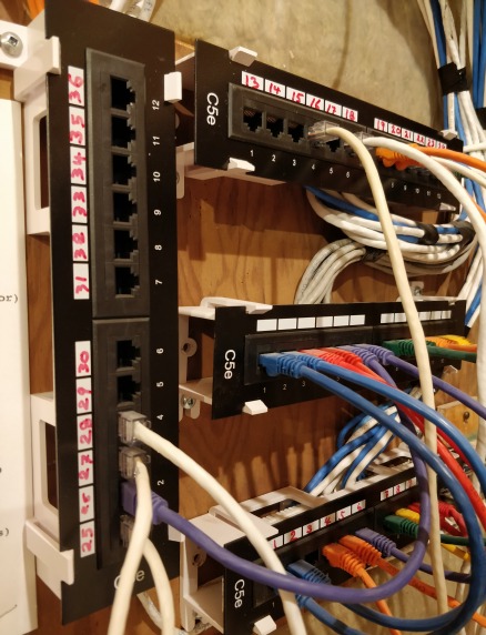

Or more specifically, I suppose the panels I am familiar with are not actually "keystone", but rather banks of rj45 jacks with punch posts on the backside. Photo attached from our home. Edit: I get my stuff from a nearly "local" wholesale supplier: http://www.computerplug.com/nav.php?cat1=Networking&cat2=Patch_Panels_and_Accessories The 12-port CAT5E panels I use are about CAD$22 each; a 96-port CAT6 panel sells for about CAD$200.
Description: The rj45 patch panels I use here.

Those are the kind I didn't like  What are you paying $2/jack for in that photo? Doesn't it come as one 12-port punchdown panel? The keystone panels I'm talking about are like this one. Just a piece of metal and nothing more. I actually wish they didn't all come with numbers on them. I'll probably tape over those. I just prefer to punch down all the cables in my hand, rather than doing it at-height at the rack. If you're lucky you're dealing with a hinged rack and it just swings out. I don't like the "mount it 1U down and backwards then flip it up" thing. Either way, especially when you start getting to the rack-mounted 24-port (or god forbid 48 port) panels, I can't seem to get the cable tension right. And heaven help you if you don't punch down one wire fully and now you have to get behind a bunch of others. I'd rather just terminate a bunch of keystones and plug them in wherever I want. There's also these, where it's just a keystone coupler in each port, and you terminate every cable with a standard RJ45 end. This might be my least favorite option, as I really hate terminating RJ45 if I have to do more than about 4 ends in a sitting.

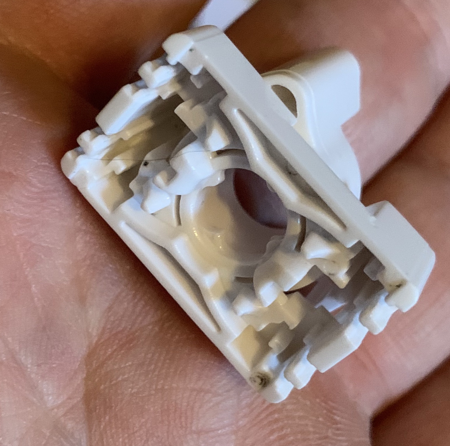

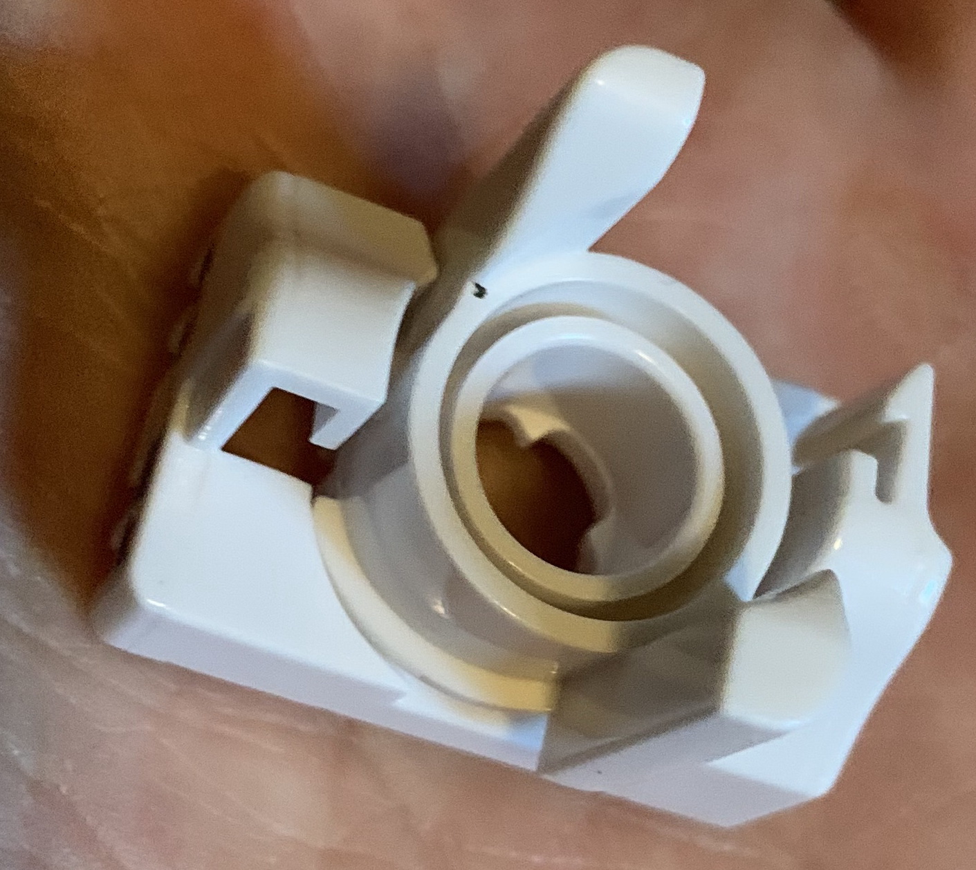

I'll try to take a picture of it, tonight, once I am home. At the time I remember finding various brands (all unknown to me) using this system. But, I made a quick search now and I can't find any. No brand or model anywhere! Sorry. I took a number of pics for you to see. I’ll tru to post them later or tomorrow. Hopefully they’ll help u find similar products.

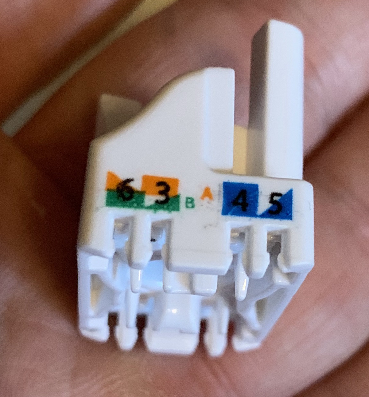

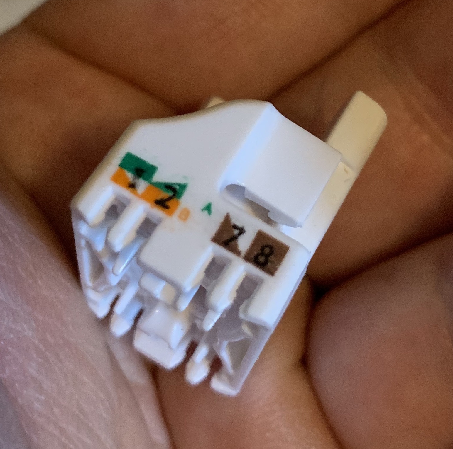

No brand or model anywhere ...
Have a close look on the molded plastic of an unused/spare connector. Sometimes there will be a tiny logo or part number/name embossed into the plastic mold.

So, no logo or name anywhere
#372166 - 22/07/2019 10:09
Re: Patch panel vs keystone?
Nope. Sorry.
Funny thing is that when I bought this (2 years ago, I realized by looking at my Amazon order) I remember there were few other patch panels all with a similar system. Nothing now. That is unfortunate. I really like the system.
#372167 - 22/07/2019 10:15
Anyway, as you could see, cable goes through the cap center hole, then individual wires are separated and go into their specific place, still in the cap. Then you cut the part of the wire that sticks out. Then, finally, you place the whole "assembly" (cable + cap) on the patch panel - a notch will guide you and insure proper positioning - and finally you twist the rotating part of the cap. That will screw the assembly in place, and press the cables and insure electric contact. I've done this quite a few times and it never failed. I am really surprised there's no company to own/patent/brand/sell this. It's a clever product and using it is faster than explaining it in words.
Oh well.
edit: unless there's some weakness I am not aware of, but I've been using it for two years without issues. It's CAT6, supposedly, and I do get 1Gbps full speed on virtually anything connected to it (NAS, servers, APs, etc.).
Edited by Taym (22/07/2019 10:17)

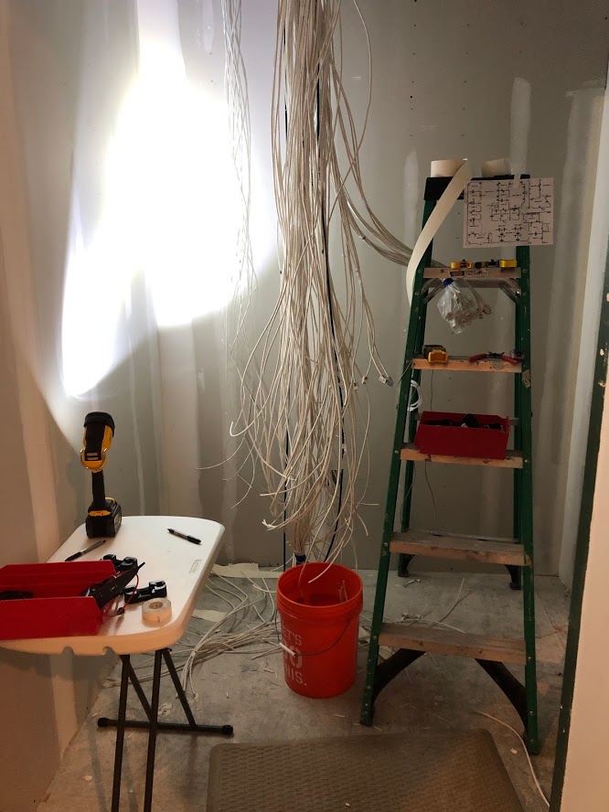

#372191 - 07/08/2019 20:43

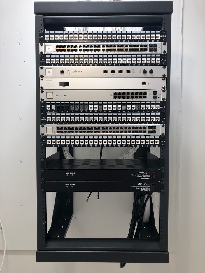

I've pulled the lines. It took forever. I need to hire people.
But here's before:
#372192 - 07/08/2019 20:43
And here's after:
#372193 - 08/08/2019 01:57
I've pulled the lines. It took forever. ... Did I mention this Sandman telecom installer web store? Back when Mike Sandman was still running the place it used to have a lot more unique tools and products for telecom and related wiring. I suspect you might find some of their tools and tips helpful. There are also several install tips videos hidden way down at the bottom of that page. One tool that seems to no longer be offered is a slingshot rig that fired a thin ‘string’ across the open space above a tiled ceiling (typical office ceiling). Open up a ceiling tile at one end, aim way across the space and shoot the tethered ball quite far. Then attach the actual cable(s) and pull it back across. Much faster than using fiberglass rods. Although some of their rods are quite nice.
#372195 - 08/08/2019 14:50

I have no significant experience, but would it not be wise to have a couple of cable management 1RU pieces?
Looks nice now, but how will it look when patched?

I seem to have forgotten to take a photo of it patched, but I think it still looks good. I'm not sure what kind of cable management piece you're referring to. Do you have a link?

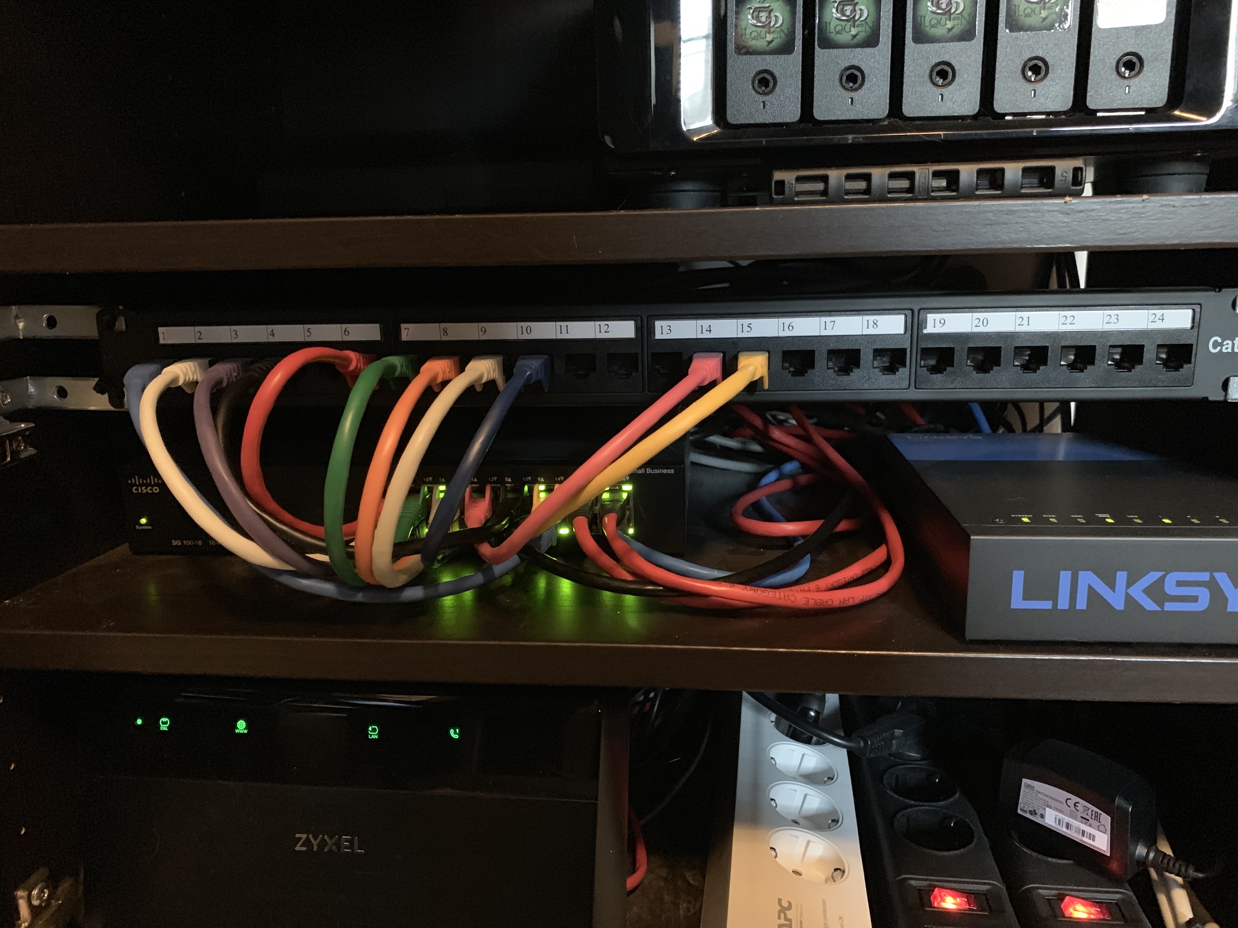

Ah ok. I'm not sure why I'll need that though? all the lines come into the back of the patch panel, then all my connecting are with short patch cables. I took a photo last night...
#372219 - 22/08/2019 13:22
Sure, patch cables are rarely the exact right length, but you can get pretty close  I also organized the rack so that I could use mostly a single length of patch cable (6"), and as a bonus the switches get some room to breathe. I generally try to keep dozens of patch cables in varying lengths on hand in general, though for a project like this, my design let me put in a bulk order for ~120 6" cables. I never make my own anymore. At least not in this quantity. It's not worth my time, TBH. And I can pass the cost along to the client anyway
