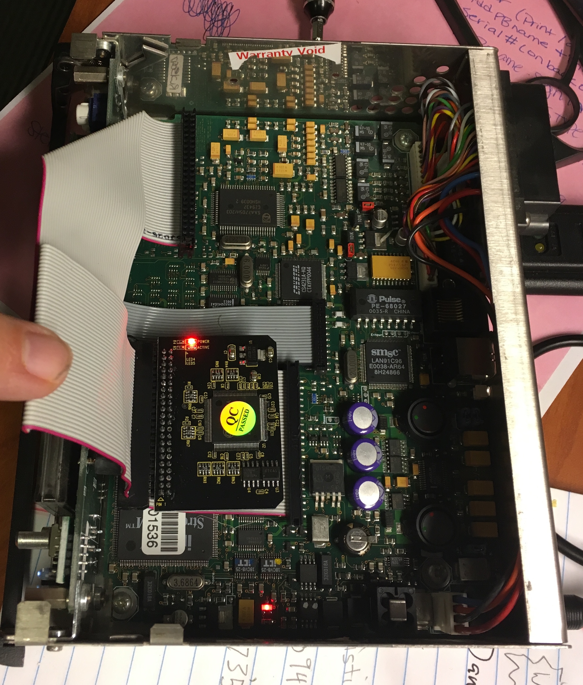

#371925 - 12/05/2019 19:24 Re: Replacement SSD? [Re: elperepat]
Originally Posted By: elperepat
Aliexpress seems to have quite a few available. But if you take in consideration the shipping time (at least for here in Canada), it might be as long as waiting for a Kingspec somewhere else.
I ended up getting two of the KingSpec 128's from Aliexpress, from your link. They arrived just fine and then sat around for a bit. But now I'm trying to use one, and having trouble putting it into one of my backup empegs. Anyone know what to do about this? I'm thinking this is something Mark Lord might know about.
Here's the situation:
I believe I did the correct things to use the bigdisk builder image on the drive, and it seemed to complete successfully. Connecting to the serial terminal after the application of the builder image was done, I see a bunch of numbers scrolling by which I think was the hard disk stress test. I powered it off then I applied a Hijack bigdisk 2.0 beta 13 image onto it. Then I applied Hijack v524.hijack.mk2.zImage onto the player. Everything seemed to work correctly.
But now that I'm trying to boot the player directly, and work with the drive, any time I have this drive plugged in (either by itself or in combination with another disk drive) it keeps saying "no primary hard disk" and "no secondary hard disk".
I don't know what the jumpers should be set to on these things, there's no dox. When trying to configure it as the solo drive in the player, I've tried configuring it with no jumpers, and with jumper on 1+2. When trying to configure it as the secondary drive in the player, I've tried configuring it with jumpers on 3+4. There's also some notes here which seem to indicate that "1+2" is "Cable Select" mode but I'm not so sure. I'd expect no jumpers to be cable select mode. Then again, different drives might be different.
Anyway, here's a boot log if this can help with diagnosis. Thanks in advance for any help or advice you can offer!

#371926 - 12/05/2019 19:38 Re: Replacement SSD? [Re: tfabris]
Posts: 5694
http://blog.differentpla.net/blog/2004/0...music-partition
I'd guess that you're missing the '/drive0/fids' and '/drive0/var' directories.
Just to check that the builder worked properly, can we see a 'cat /proc/mounts' and an 'fdisk -l /dev/hda' (lower-L) as well, please?
#371927 - 12/05/2019 19:53 Re: Replacement SSD? [Re: Roger]

Found a 1.8" form factor with 44-pin IDE/PATA connector: https://www.amazon.ca/gp/product/B0099395FA/
Ordered, should be here tomorrow. We'll see if it works correctly or not.
That drive arrived here just a few minutes ago. Fired up the bigdisk builder (v6) a couple of minutes ago,
and now the builder image is running from the drive formatting everything else.
EDIT: Done! Installing v3a11 software onto it now.
Edited by mlord (15/05/2019 20:25)
#371968 - 15/05/2019 20:43 Re: Replacement SSD? [Re: Roger]
Posts: 14548
We have had a winner!
The 1.8" Kingspec IDE/PATA drive I found on Amazon Canada: https://www.amazon.ca/gp/product/B0099395FA/
Builder (v6) worked without fuss, and I then installed the v3b11+Hijack .upgrade over that, again totally fuss-free.
The drive even has screw holes for mounting, two of which match the empeg's drive sled.

Jumper settings on the 1.8" form factor genuine Kingspec drive:
Description: Kingspec KSD-PA18.6-XXXMS jumper settings.
#371972 - 15/05/2019 21:55 Re: Replacement SSD? [Re: mlord]
Posts: 14548
I've now used my Linux PC to copy over 27GB of tunes directly to the new SSD
(much quicker than doing through the empeg itself)
and it's now running and playing nicely from the new drive.
So.. pity there aren't more of these out there,
but I imagine that a modern fast CF Card with a passive adapter would do just as well.

#372008 - 25/05/2019 03:44 Re: Replacement SSD? [Re: mlord]
By all means please DO report your findings, along with the exact card used in
So mixed results so far. I installed the little converter and SD card (the card is on the bottom side of the board):
I'm able to run the big disk builder upgrade file, then the player 2.01 upgrade file. After that I can copy music to the drive and play it. Everything is good up to this point. The only problem is that the moment I pull the power, I lose the ability to connect to the SD card. The player says No Hard Disk Found, Contact Support. This seems bizarre, because it was happily playing music seconds before. I've duplicated this behavior with both the 32gb card, and an old 1gb card I had laying around. Seems consistent with what some are reporting in the Amazon comments. I'm wondering if it's just not handling a non-windows filesystem very well?
#372009 - 25/05/2019 03:53 Re: Replacement SSD? [Re: Roger]

#372010 - 25/05/2019 11:17 Re: Replacement SSD? [Re: Roger]
Posts: 14548
Interesting. It's as if nothing was ever written to the card during the various install steps. Or perhaps a counterfeit card that has (much) less capacity than advertised, resulting in sector "wrap around" which then destroyed the partition table.
Except you got it with more than one card. So probably not the card.
EDIT: The above boot log is from AFTER installing everything, right?
Edited by mlord (25/05/2019 11:18)
#372011 - 25/05/2019 11:31 Re: Replacement SSD? [Re: Roger]
Posts: 14548
I have read through some of the Amazon reviews for various versions of this adapter, and the common theme seems to be that the partition table gets rewritten to the SD-Card at power on. Always with exactly one MS-DOS partition populated.
The interesting question then becomes, is the rest of the SD-Card still intact? If so, we could kludge a reasonably simple work-around in Hijack to just ignore the read-in partition table, and instead use either a saved copy or an auto-generated table (partition tables are only 512-bytes long, plus whatever "extended" partitions exist).
I suppose the onboard firmware might be doing something stupid like, "if card isn't something I recognize, then auto-format it at power-on". In which case it's a matter of determining how it "recognizes" the card. Most likely it just looks at the partition table. If that's the case, then we just tell Hijack to offset everything by 1 sector, nothing else required. smile
If you want to try this, I can provide a suitably hacked kernel, builder image, and car2-software image with that kernel.
Edited by mlord (25/05/2019 11:31)
#372012 - 25/05/2019 11:57 Re: Replacement SSD? [Re: mlord]
Posts: 14548
Ha! There is already a mechanism to do this kind of thing in the IDE driver in Linux. I added it decades ago to deal with "EZDRIVE" partitioning software that did something similarly silly with the partition table.
So a possible workaround here simply involves enabling that code, and checking for the specific brand/model of SD Card converter. Done. Try this (attached).
Note that this is safe (aka "inactive") for use with regular drives too.
EDIT: Replaced builder+image with a single combined builder image.
builder_bigdisk_v6+-sdcard.upgrade (530 downloads)
Description: Single combined builder/software file.
Edited by mlord (25/05/2019 18:32)
#372013 - 25/05/2019 12:03 Re: Replacement SSD? [Re: mlord]
I've got another engagement this morning, but I'll try it later today.
#372015 - 25/05/2019 12:12 Re: Replacement SSD? [Re: mlord]
Posts: 14548
Kernel code change to enable the (possible) workaround:
--- v524/drivers/block/ide-probe.c      2009-09-14 08:39:40.000000000 -0400
+++ hijack-v524+/drivers/block/ide-probe.c      2019-05-25 07:47:10.952063665 -0400
@@ -86,6 +86,20 @@
        printk("%s: %s, ", drive->name, id->model);
        drive->present = 1;
+#if FAKE_FDISK_FOR_EZDRIVE
+        * Try and deal with SD-Card adapters that rewrite an MS-DOS partition table
+        * at every power-on, by remapping sector 0 to 1.
+       static const char sintech[] = "SINTECHI HighSpeed SD to CF Adapter";
+       if (0 == strncmp(id->model, sintech, strlen(sintech))) {
+               drive->remap_0_to_1 = 1;
+               printk("[sdcard remap 0->1] ");
+#endif
 #ifndef CONFIG_SA1100_EMPEG
         * Check for an ATAPI device
--- v524/drivers/block/ide.h    2017-08-06 08:36:18.000000000 -0400
+++ hijack-v524+/drivers/block/ide.h    2019-05-25 07:45:06.083976833 -0400
@@ -41,7 +41,7 @@
 #define INITIAL_MULT_COUNT     8
 #define SUPPORT_SLOW_DATA_PORTS        0
 #define SUPPORT_VLB_SYNC       0
-#define FAKE_FDISK_FOR_EZDRIVE 0
+#define FAKE_FDISK_FOR_EZDRIVE 1
 #define FANCY_STATUS_DUMPS     0
 #define REALLY_FAST_IO         1
 #undef  INITIAL_MULT_COUNT

#372018 - 25/05/2019 23:08 Re: Replacement SSD? [Re: mlord]
Posts: 14548
Note that the combined builder image is a Work In Progress. I will release a more polished version at some point, likely at The Meet.
#372019 - 25/05/2019 23:14 Re: Replacement SSD? [Re: mlord]
Still no love. Played music and everything, just didn't survive a power cycle.

Roger was kind enough to pick up a SINTECHI adapter for me in the UK, and I have been playing with it here for an hour or so now.
It seems to behave just fine with a 4GB SD-Card, and with a 16GB SD-Card, but not with the 64GB card here. I don't have anything in between 16 and 64GB to try it on, but I suspect some kind of capacity limitation.
EDIT: The onboard chip is labelled as FC1307, but also has a letter A literally scratched onto the surface after the FC1307 part. So it is either a FC1307A, or a counterfeit of some sort.
If anyone at the Meet has a 32GB card for me to try, I'll report back on that later as well.
Edited by mlord (07/06/2019 21:01)
