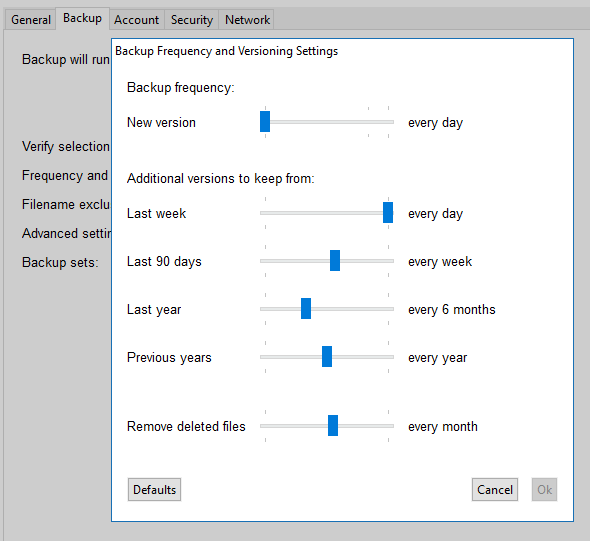

#368700 - 21/04/2017 23:52 Re: Backup Problem [Re: tanstaafl.]
Okay, time to look at CrashPlan, I guess.
I've been playing with CrashPlan for a bit now. Its philosophy of operation is quite different from what I have been doing for the last decade and a half, but it looks like it can do what I need if I change the way I think about backups.
What I've been doing is to create near-clones of my C: and D: drives on my E: drive. That is, my root directory on E: shows "Disk 1" and "Disk 2". Disk 1 had the same directory tree and file structure as my C: drive, with the notable exception of the Windows directory and a few other files that wouldn't copy over because of in-use status. Disk 2 was a byte-for-byte reproduction of my D: drive. Similarly, my F: drive was byte-for-byte copied to an external USB drive L:. and just for a belt-and-suspenders mode, finally the C: and D: drives were copied again to an external USB drive M:, making the E: and M: drives identical twins. Finally, a few times a year my E: and F: drives were copied to N: and O: external drives which are kept off-premises at a neighbor's house. Backups were done at my discretion, on my schedule, not automatically. (They could have been automatic, but I'm enough of a control freak that I opted out of that.)
The point of the above confusion is that I had access to backups that could be used as-is in place of the original drives, except there was no backup of my operating system. I plan to address that shortcoming as part of my transition away from Karen's Replicator.
CrashPlan keeps all the backups in a single compressed, encrypted archive file. Well, in my case I decided on no compression and no encryption, but it is still all in a single big file. I'm not entirely sure why, but this idea makes me uncomfortable, sort of an "all my eggs in one basket" feeling. Also, CrashPlan insists on doing the backups on its schedule, not necessarily mine, Its default is to do a differential backup (or would it be incremental?) every 15 minutes in background. This is contrary to my philosophy. I don't view my backups as a tool to recover from a crash or failed hard drive, but as a safety reservoir I can go to when I screw up a file so badly that I need to replace it with a saved copy. If my backup program replicates my screwups every 15 minutes, that is counter-productive!
But... I can (and have) set CrashPlan to do its work just once a day instead of every quarter hour. It would appear that CrashPlan is backing up incrementally, and saving older backup data. I assume that the "Restore" function in CrashPlan is somehow sorting all that out and somehow allowing me to recover the particular version of the file that I want should the need arise, but I haven't played with Restore enough to understand how that will work, just enough to know that without the CrashPlan application up and running I have no backups available.
That leads me to my two main questions about CrashPlan.
1) Assume the worst, my SSD has died, nothing recoverable on it, including my installation of CrashPlan. Now what do I do? At a guess, I would go to the system clone copy I made previously with such impressive foresight and kept on... uhh, kept it on what? A flash drive? One of my internal hard drives? An external USB drive? A 180KB 5-1/4" floppy? (Just kidding...) What do I do to address this problem?
2) I have my power management set to turn off the monitor after one hour of inactivity, and start sleep mode after two hours. What happens if CrashPlan is backing up data when the two hour cutoff comes? I have been caught by this before with other background operations. I understand that after the initial backup archives are created, the subsequent incremental backups will take very little time, and this problem will not arise. But my first backup of my D: drive and in particular my F: drive (~2 TB) are going to take a long time. Do I need to disable my power management for those?
Below are the backup frequency settings I have chosen, but it is quite possible that I totally misunderstand the nature of these backups and have done it all wrong. Given what I have written above (sorry to have made you wade through all of this) are these reasonable settings? And what do you recommend that I do to make and keep a system clone stuck away in a drawer somewhere in the event of a total SSD failure?
#368701 - 22/04/2017 00:46 Re: Backup Problem [Re: tanstaafl.]
Yes there are large files but I think they are split to 4GB so not exactly one big file. I had a feeling the blob concept might make you uneasy but for what Crashplan does with history and versions it's really not feasible to have a direct copy of your folder structure.
15 minutes is not counter productive. It keeps *every* copy it takes every 15 minutes so you can restore any of the backups depending on how far you want to go back. That's what the screenshot you took shows by default except you've changed it to daily. As they get older, it goes down the list when pruning the backups i.e. the 15 minute backups only last for the current week. Then it just keeps daily copies from the week before, then weekly copies from the last 3 months and so on..
Your changes will result in smaller size of your backup sets, but will result in less "coverage" and also completely removing a deleted file after a month. e.g. if you edited a file all day and screwed it up late in the afternoon, your whole day's work would be lost as the most recent backup would be up to 24 hours old. If you had 15 minute backups you could go back in 15 minute steps (for the whole week by default). Covering your screwups I think you might want frequent backups and if you want to keep the size down, just set the additional versions as appropriate.
Further to this the 15 minute thing by default only keeps 1 week of 15 minute backups. AFter that it keeps one per day for 3 months, then once per week for the last year and then once a month forever. So it's not keeping 15 minute copies forever.
Note also it will not backup the file unless it changed so every 15 minutes it's likely to only backup a few files. Note also you have to save for it to backup i.e. keeping you spreadsheet open but not saving it for hours won't work.
Also, with your settings, if a file goes missing by being moved or deleted and you realise over a month later, you can't get that file back. That's why that last setting defaults to "never".
It's fine to use them as long as you understand the impact of having less frequent copies of your data. That's basically what those settings do - thin out the older versions so you can have history going a long long way back but not keep every 15 minute copy. Most backup systems have this concept.
You can "force" a backup by pressing play on the backup set (it should keep track of changed files) or doing a file rescan.
So yes when you restore, you can restore a snapshot based on time OR if just one particular file you can browse the tree and underneath each file will be each copy that's been taken and you can pick the one you want.
Your questions
1) If your system dies, you need to get it up and running outside of Crashplan as it doesn't do bare metal recovery as noted. Other tools can do system images allowing a full restore. As I said, I probably end up doing a reinstall anyway to remove some of the cruft I end up with. So recover to a working OS, install Crashplan. I think you might have to login and then under destinations just select the backup location as you did when you started and it should just read the backup set from your drive
2) Yes if your system goes to sleep there's not much Crashplan or any other backup can do about that. It will pickup after resuming though. Only issue might be that noted by Andy above where really huge files don't get a chance to finish so have to keep restarting. I've seen something like that happening but Crashplan backing up to their cloud (i.e. paid service) does appear to be able to resume backups. If the file keeps changing though that might be problem.
I leave machines on all the time so the sleep thing probably never hurts me but I would be confident in just letting Crashplan do its thing. For your first backup if it's terabytes of data then yes I would turn off power saving to get a proper start.
HTH

I strongly suggest that you leave the defaults alone
Given the absolute certainty that you know far more of this than I do, I will change back to the default settings.
When I changed those defaults, I didn't fully understand that CrashPlan retained all of those 15-minute changes rather than over-writing. Incremental backup vs Differential.
Thanks for pointing me in the right direction.

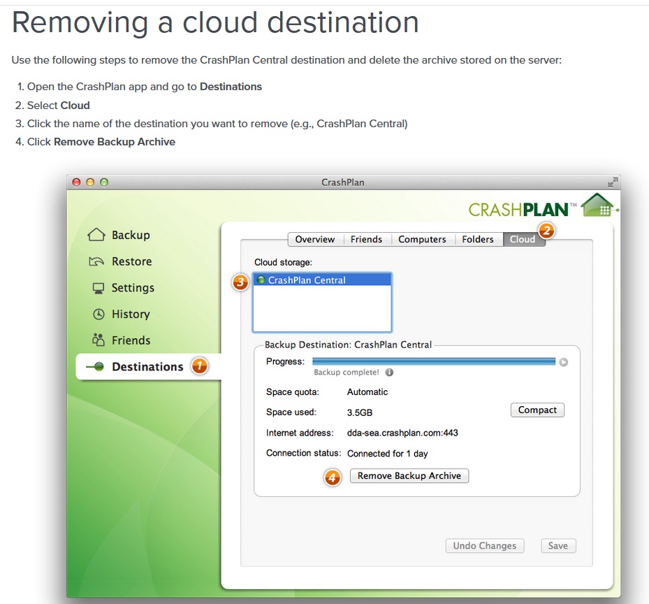

And... CrashPlan really wants me to do a cloud backup, to the point of putting in a non-deletable backup set to send my Desktop to the Cloud. I think I got around that by parameterizing that one set to backup only between 12:00--12:01 AM and un-checking all of the Monday--Sunday allowable days. We'll see...
Now the question is how do I go about making a restorable clone of my C:\ system SSD? I have several suitably-sized hard drives kicking around that I can put into a USB enclosure. Can I clone to that? Would I clone the entire hard drive or just the Windows directory? Finally, what software is recommended for this? Patrick likes the AOMEI software, are there other recommendations?
Edited by tanstaafl. (23/04/2017 16:57)

Just delete that bottom backup set if you don't want it from the Settings page -> Backup tab.
If it's the original one it created (I presume based on the name) then I think you can't delete it, you could have just made it one of your backup sets.
To stop it backing up to the cloud, select the backup set (under Settings->Backup), in the destinations panel click "change" and then uncheck Crashplan Central
I see you have no files selected anyway so it won't back anything up but I know it would irk me having the extra backup set there even if it was harmless.
#368717 - 23/04/2017 16:53 Re: Backup Problem [Re: tanstaafl.]
Actually... you can delete that hard-wired Cloud set. I was one keystroke away from deleting it, then decided to leave it in just to keep my future options open. I changed its backup priority to "4" so it is at the bottom of the list and doesn't annoy me too much.
I have one more set to add to my backup list, the backup of my C: and D: drive backups which will go to the M: drive, a 465GB USB external drive all packaged in a nice enclosure. There are 27 GB of truly non-essential data data on the C: and D: drive that I won't include on the M: drive backup, leaving me with 164 GB of headroom for further storage as the D: drive grows.
