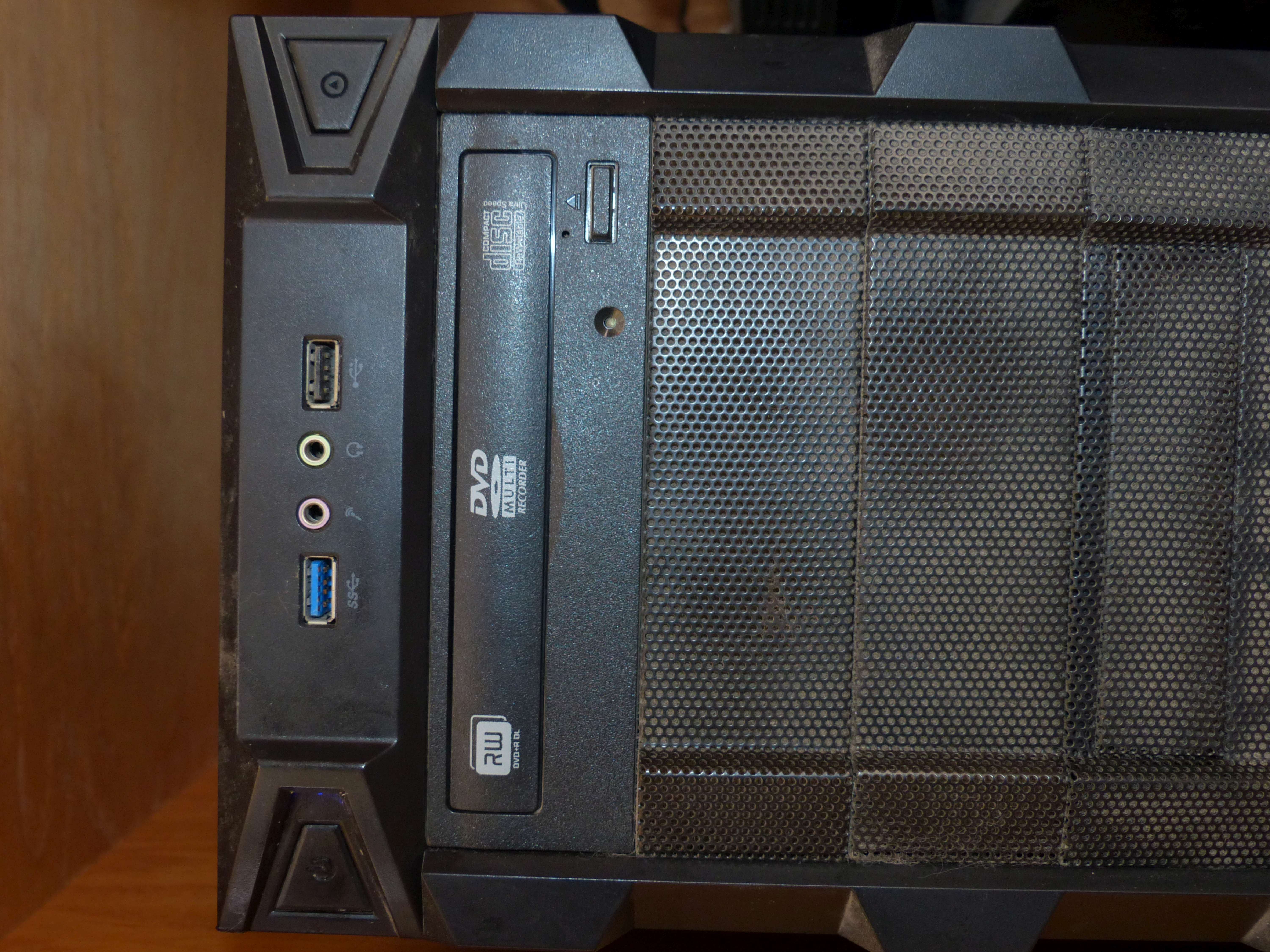

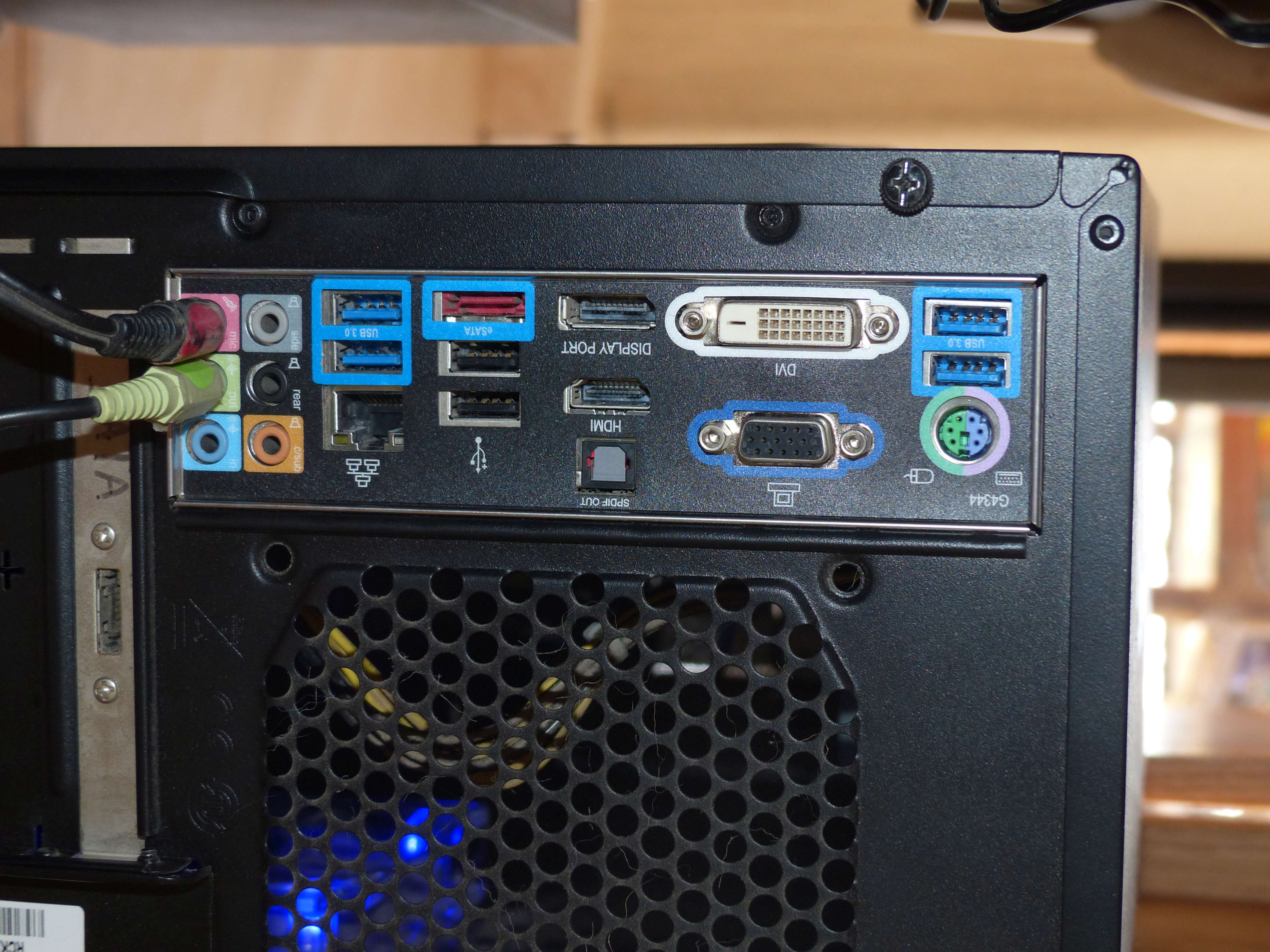

I am pretty sure that the USB ports in question are on the backplane of the motherboard. See the photos. I am assuming that the "black" USB connectors are USB 2, and the "blue" connectors are USB 3. I don't know what the SS--- symbol on the blue connector on the front panel means.
In any case, the only "blue" connector that functions on the whole computer is the one on the front panel. The only USB connectors of any kind that function on the back of the computer are the two black ones. If you zoom in on the pictures (I am leaving them as high a resolution as the bbs will allow for clarity, sorry for the download time) you can clearly read all the labeling.

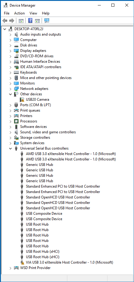

look for little yellow boo boo icons in Device Manager.
None visible if I am looking in the right place. (see screenshot)

You have two yellow boo boo icons in that screen shot. One on your USB camera, and one on your USB 3.0 extensible host controller.
"There's your problem".

Based on the Device Manager screen shot, the issue could simply be a bad device driver on the USB3 controller.

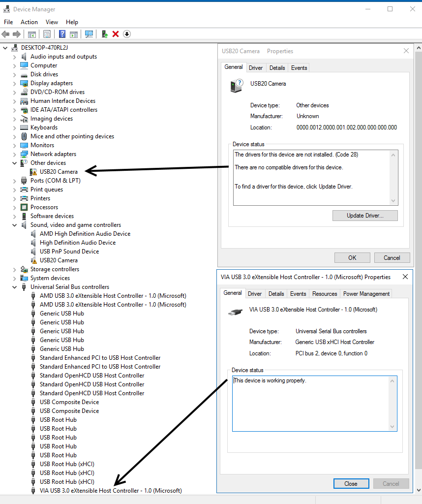

My bad. I thought those boo-boo icons were larger, I just overlooked them.
The camera I don't care about. It is an inexpensive Microsoft webcam that apparently has been orphaned - there are no drivers available for it anymore, probably happened when I went from 32 to 64 bit computer.
The Via 3.0 eXtensible Host Controller - 1.0 (Microsoft) I am more concerned about. I made the yellow boo-boo go away by deleting and reinstalling the driver. Everything looks good, except that none of the 3.0 USB ports on the back of the computer work. Still.

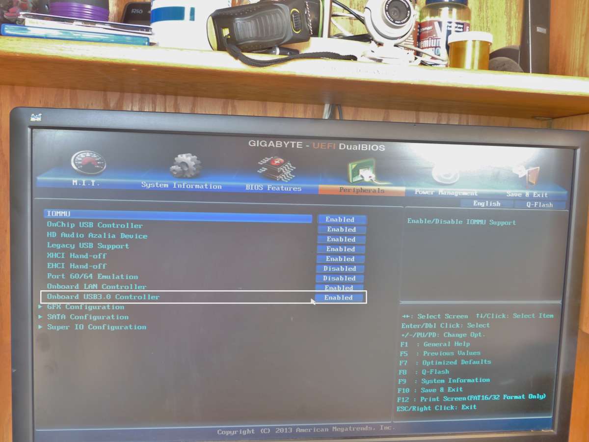

Check to make sure that the USB3 controller isn't disabled in the BIOS somehow.

With all 17 USB devices (yes, 17) unplugged, I booted into BIOS and plugged a USB mouse into one of the blue USB-3 ports. It worked. I tried the other three USB-3 ports. They all worked. I tried the two black USB-2 ports. They worked. I tried the blue USB-3 port on the front panel, it worked. I tried the black USB-2 port on the front panel. It worked.
After booting up into Windows, only the two black USB-2 ports on the backplane, plus the mixed pair (one blue, one black) on the front panel worked. Those four USB ports have always worked. Only the four blue USB-3 ports on the backplane have failed.
