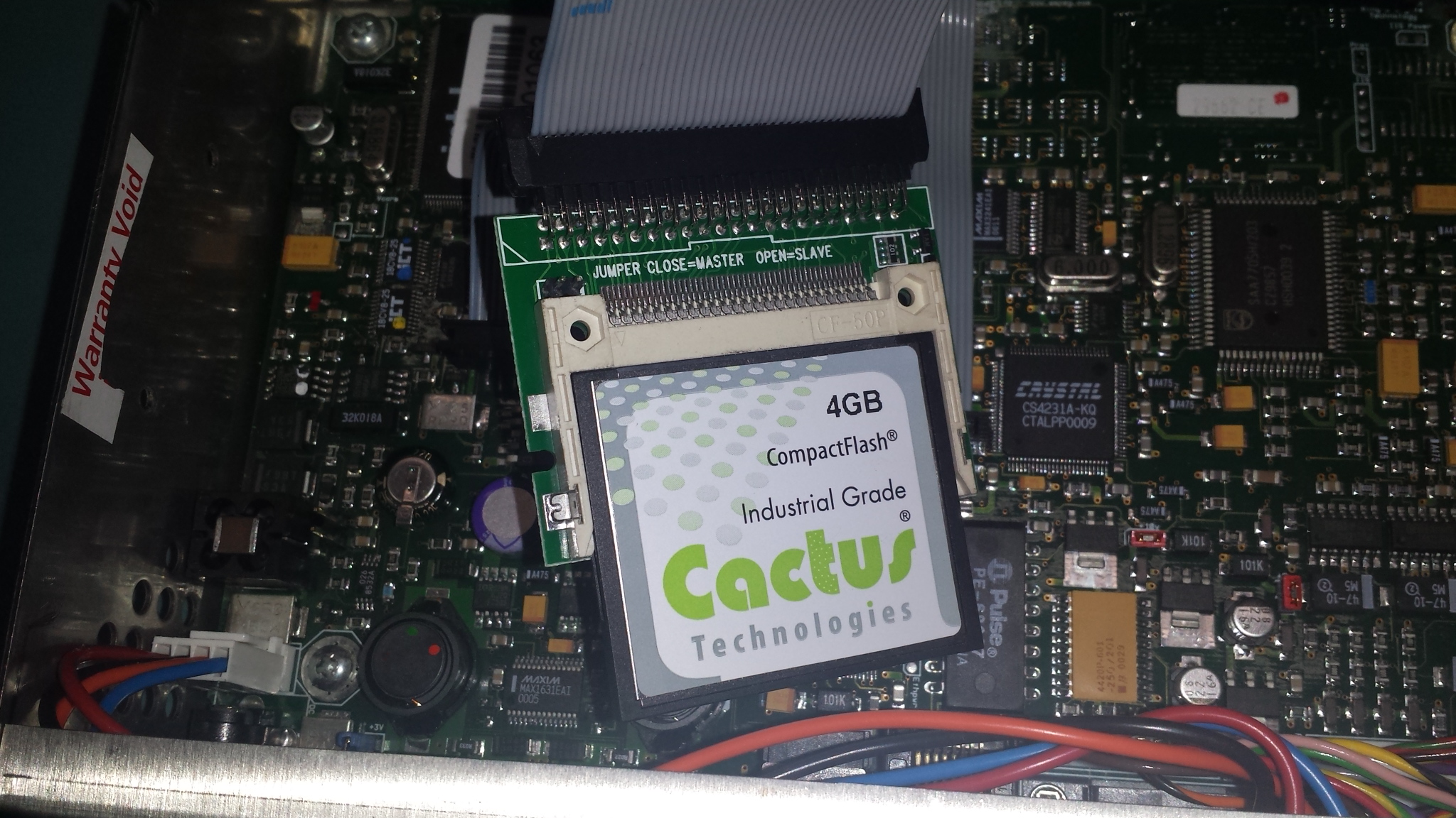

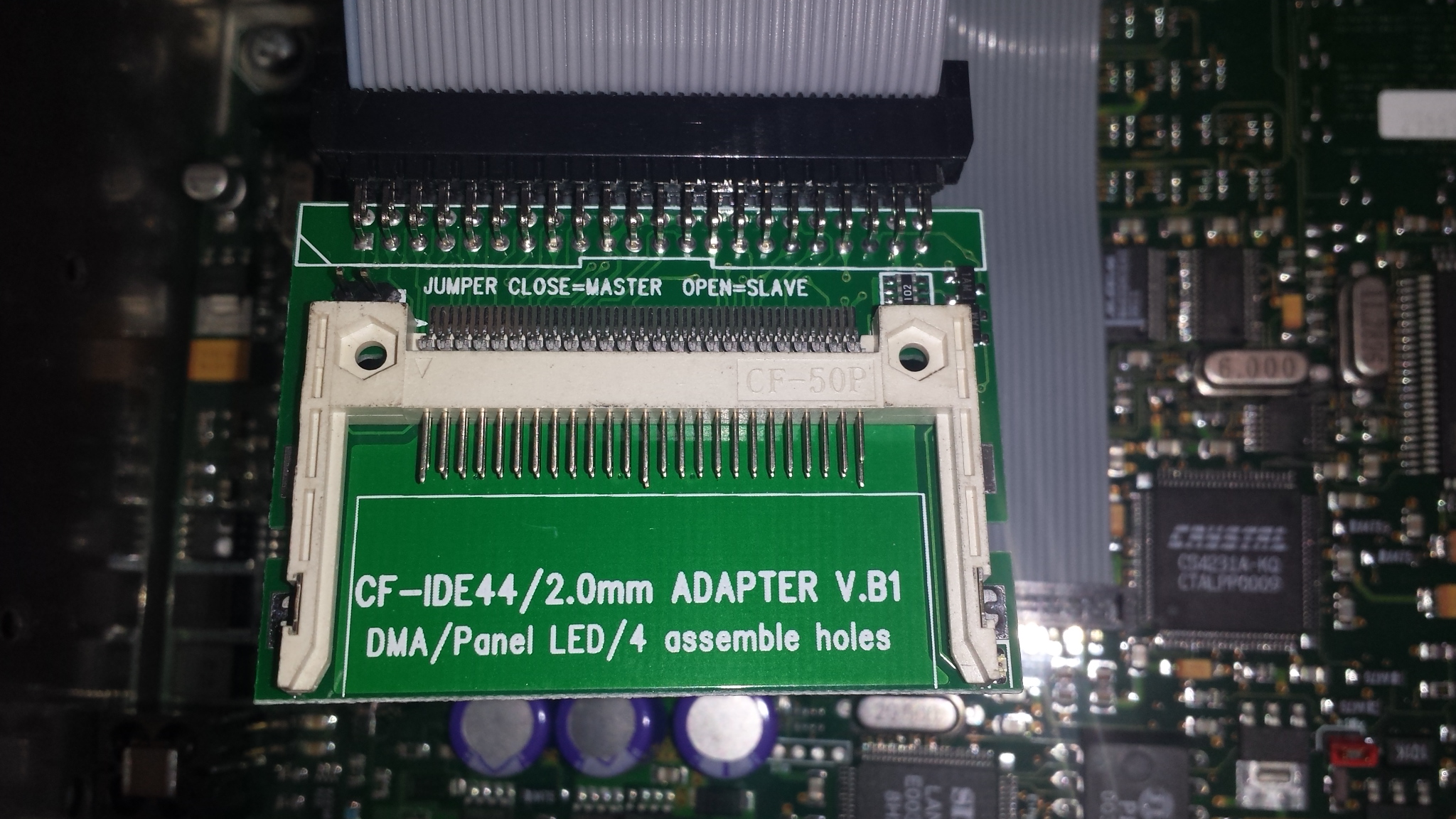

Well, my Empeg started working very well after my last post and its installed in a vehicle that did not get driven much so I did not try the upgrade. Now I am attempting the upgrade and am unable to get my CF card to recognize. I have formatted it on a windows XP computer as FAT32 trying both the regular and quick format options. On the Empeg display I get ("0000.14 hdb: err: stat_err") and eventually I get the pump error. I know 4GB is small but should it work? Check my pics and let me know if you anything I am doing wrong. FYI, I can remove the CF adapter and plug my factory 12GB drive back in and it will identify that.

4GB should be fine, IIRC it's the lowest size that the Mark 1 empegs shipped with.
Two things to address that I can see from the photos and process that has been done so far:
1. Add a jumper on the CF adapter to set it to master, if the CF card is going to be the only drive.
2. Download and apply the Disk Builder upgrade from here: http://www.empeg.com/downloads
Detailed instructions on using the disk builder can be found in Tony's drive upgrade FAQ starting at step 6. http://www.riocar.org/modules.php?op=modload&name=Drive_Upgrade&file=index

Tom, thanks for the response. I did have the jumper off in the picture but it made no difference. Maybe I have a faulty CF adapter because it will not recognize no matter what I do. I went ahead and just used a spare drive from an old laptop (which worked fine.) I will see how long I can get by on that.
