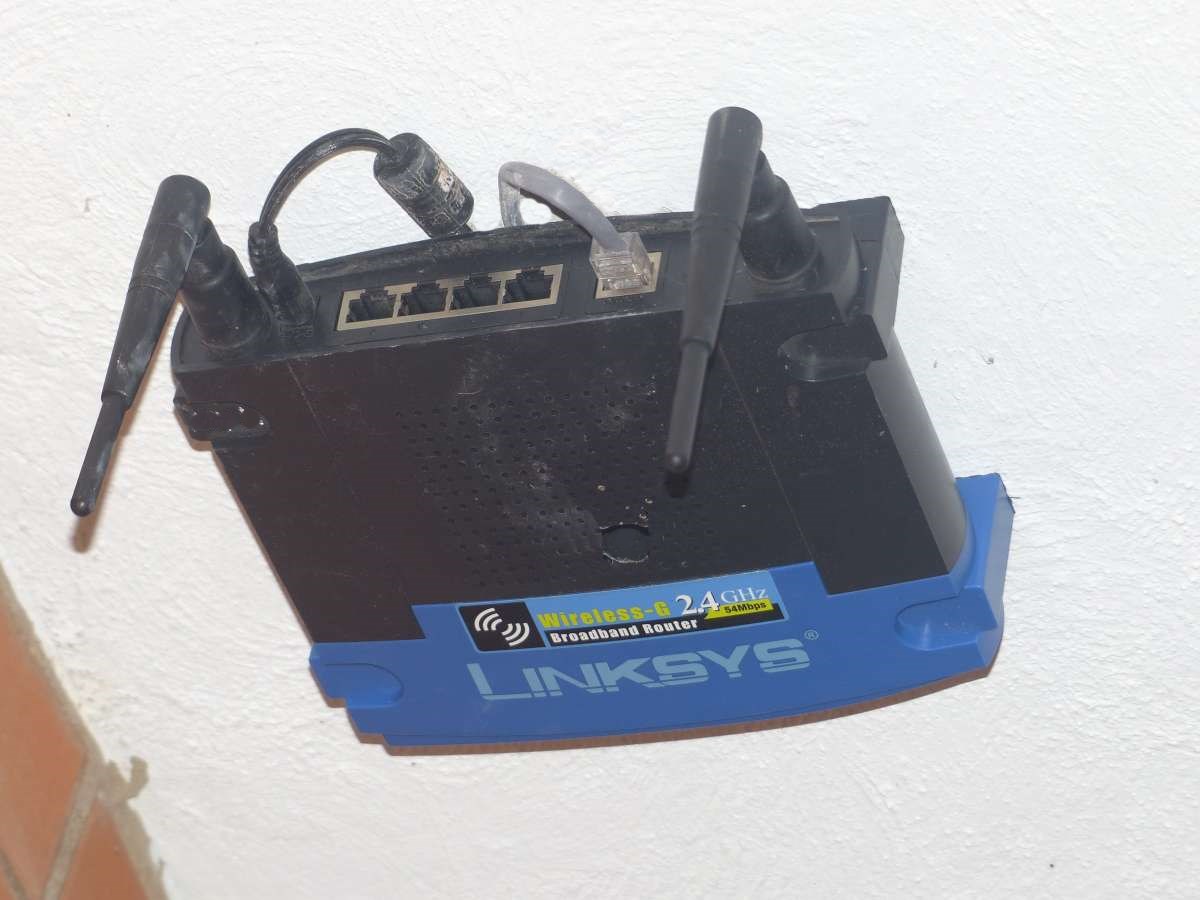

One small difficulty will be securing the router to the ceiling...
Uh-oh! I have to get power to the router as well. Can I run the power cord right along the Ethernet cable without causing interference?
Some routers have keyhole style mounting holes on the underside, which can hold the unit to the ceiling of the holes are carefully located and the screws are just the right size to provide a snug fit, and screwed in until they just barely allow the slots to fit over the screws and slide into position.
If you choose this method, I can provide a tip for getting the drilled hole locations fairly precise without any measuring.
There are purpose made ceiling mounts, this one fits the compact Apple Airport Express router.

I suggest making the hole a tad larger, perhaps 3/4" size. Power cord for the router with end attached will need some wiggle room, and the sharp cornered RJ45 plugs tend to snag.
Thread a pull cord (string) through first, then draw one cable at a time through. Make the pull cord long enough that you don't pull the other end through, create a loop in the middle and use that to bring the cord ends down.

Have any of you ever taken apart a WRT54GL router? It would simplify my installation somewhat if I could drill through the mounting feet of the router and just run the screws directly into the ceiling, but I don't want to go stirring up bits of electronics with my drill bit. The mounting feet are indented at the top and project out the bottom, so that multiple routers can be stacked on on top of another, but are not hollow all the way through.
What are the chances that I could fun a 1/8" or 3/16" drill bit through them?

Three out of the four would hit circuit board. You know, the UniFi AP's come with a real nice mounting kit... wink
Yes, you can drill there, but only in the outmost edge of each of the four pod/feet things. The rubbery bits can be pried out with a knife/screwdriver first, and then it is safe to drill only outside of the "curved" edges of the router body.
If you want better access, open it up. Scary the first time, but here's how:
The blue/purple front detaches from the dark main body of the router. There are no screws (unless yours is old enough to have them under those rubber pads you removed above). Instead, just firmly grab one of the two back "feet" in one hand, the corresponding front "foot" from the same side of the router in the other hand, and pull hard/quickly. The front will snap apart from the main body, revealing the innards.
It helps to slice through the "do not tamper" sticker beforehand. smile
Looks like about 1/4" max space for drilling, on my v1.1 WRT54GL.

The secondary router will be mounted upside down on the ceiling, right over the doorway between the bedroom and the kitchen/dining room, so hopefully the signal will propagate through both rooms.
Now what I need to do is find the proper inverter software to turn the data right side up because it will be coming out upside-down from the router mounted on the ceiling. Haven't been able to find it by Googling... smile smile

I have a thin strip of aluminum that can be easily cut and shaped. I'll take 3" long pieces, bend them into an "L" shape, pop-rivet them to the hollow portion of the router's mounting feet, then screw the whole mess into the ceiling with anchor bolts.
Yes, I finally got around to installing the downstairs router on the ceiling of the apartment below mine.
I found a much simpler way of sticking the router to the ceiling, one that will make most of you a bit crazy.
The router has grillwork for cooling on both the top and bottom. By holding the router up to the light, I saw that there was an area about an inch and a half square where I could see right through the middle of the router. So I drilled right through and fastened the router into the ceiling with a single moly bolt. Works great!
I got someone who knows more about networking than I (that would consist of a subset of about 90% of the total population) to configure the downstairs router. It's connected by Ethernet from one of my ports on the upstairs router, and that's about all I understand about it.
Hey, if it works, who cares? I don't think the router is going to suffer from a lack of that half inch square section of ventilation. Being on the ceiling is probably the more thermally challenging aspect, but there should be plenty of airflow around it!
There's a few ways it could be set up, but again, if it works then it doesn't matter much. The problems that could arise from an improper configuration (like double NAT) might not even have any real world ramifications.
