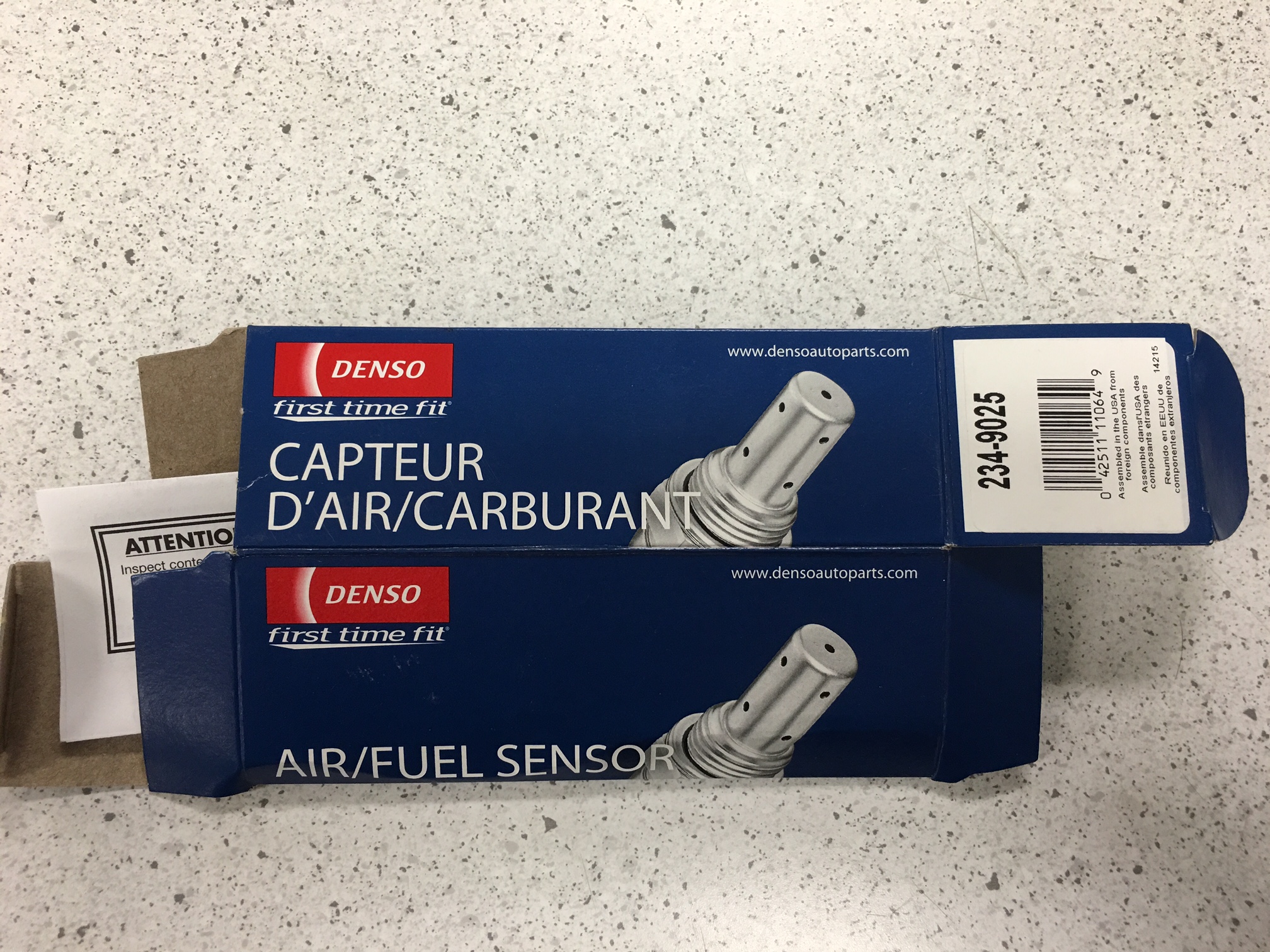

#365415 - 02/12/2015 20:05 Re: Check engine light didn't go off after repair. Did they BS me? [Re: Shonky]
The part that was actually replaced was the one labeled "Air/Fuel Ratio Sensor" in this photo. This was the "easy" one I talked about.
http://honda-tech.com/attachments/honda-...-bad-engine.jpg
Other sources on the internet said, no, the one you have to replace is the difficult one under the car. I never even looked under there to see if there was even anything there at all. So maybe that was the correct one.
My CEL still isn't off, though. I should check the fuse for the thing. Anyone know where that's located?

#365418 - 02/12/2015 23:40 Re: Check engine light didn't go off after repair. Did they BS me? [Re: tfabris]
Right so that's not a airflow sensor. That's just another O2 sensor pre catalytic converter. Often there are ones before and after the cat so it can tell how the cat is operating.
If the message means the post cat sensor, then yeah they've replaced the wrong one.
They might be the same part though so if you have the "faulty" one they pulled out you might be able to put it back in.
"P1166 Meaning: Primary HO2S" to me would mean the pre-cat one to me though so I'd say they've replaced the right one based on the code actually.

#365453 - 06/12/2015 19:52 Re: Check engine light didn't go off after repair. Did they BS me? [Re: larry818]
Current status:
I did:
- Tried looking for a fuse, couldn't find one.
- Can't figure out which relay is the one that controls the O2 sensor.
- Tried pulling the fuse to the computer for a couple of hours, didn't fix it.
Took it back to the repair shop. They did:
- Traced and measured voltage and resistance on the wiring to the O2 sensor, all good.
- Checked voltage at the relay (they apparently know where it is). Good.
- Measured resistance across the the O2 sensor itself. Not in spec, they said it's only 3 ohms when it should be much higher than that.
- Tried another O2 sensor, it also did not fix it, and also didn't have the resistance value they expected.
Next step:
Monday they will try to order an OEM Honda O2 sensor. If that doesn't work, then they want to look at the computer as a possible culprit, but I'm not down with that.

#365462 - 07/12/2015 16:57 Re: Check engine light didn't go off after repair. Did they BS me? [Re: tfabris]
Page 11-59 is the one that would help.
I found that your O2 sensor should read 10 to 40 ohms. That 3 ohm sensor is likely one for another car that happened to have the same connector. Aftermarket parts vendors are always doing this kind of stuff.
#365463 - 07/12/2015 17:35 Re: Check engine light didn't go off after repair. Did they BS me? [Re: larry818]
elperepat
Posts: 211
Loc: Qc, Canada
You say so because of the image on page 11-45? In fact, 11-59 deals with DTC P0131: Primary H02S (Sensor 1) Circuit
Low Voltage. To throw a P1166, his car probably have the wide-band O2 sensors in place of a standard O2 sensor.
Patrick
#365465 - 07/12/2015 19:54 Re: Check engine light didn't go off after repair. Did they BS me? [Re: larry818]
This is the same conclusion that my tech arrived at. I'm awaiting their word on whether they are able to order the correct part.

Third time's the charm. When they put the correct part in, the light went off and (so far) stayed off.
Here's the correct part, for posterity:

Good thing it was a "first time fit" part. What's that even supposed to mean?
