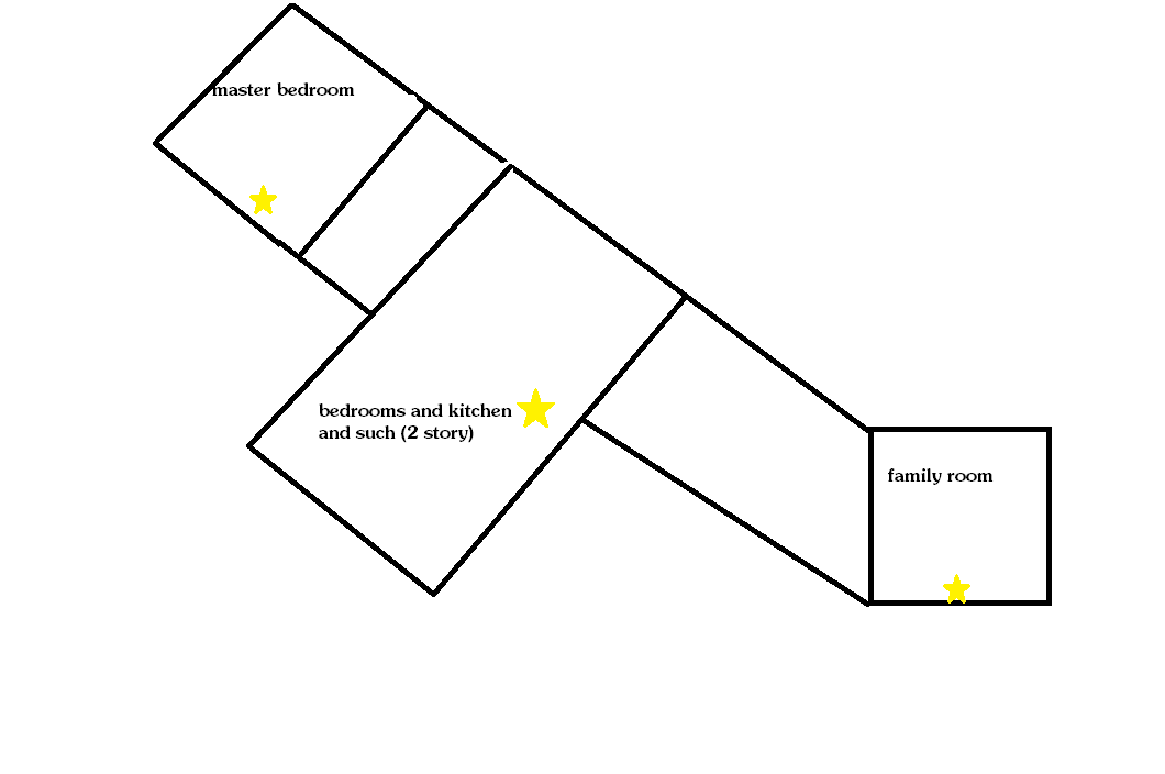

Two things:
1/ Use inSIDDer, it is free, to get more info about the other networks that are suspected of causing interference.
2/ Crack open MSpaint so we can get a better idea of the house layout and it's wings.

Two things:
Looks useful for this, but doesn't run on Mac, and I haven't yet reinstalled VMWare on the MacBook I'm currently using. I have a Windows desktop in the middle of the house, but it's highly immobile. I'll have to get around to getting Windows installed on the laptop this weekend.
That I can do. The green stars are the approximate location of the existing APs

Okay, thanks everyone for the help so far. I broke down and got a WNDR3700, then configured it as an AP to replace the one in my family room (still using the stock firmware for now). When connected to it using 2.4ghz, I still see the same problems as I did connected to the WRT54g. However, when connected to the 5ghz network, everything's smooth sailing. So, my problems are more or less solved.
However, I've got a couple of more questions:
1) Is there some way to configure the 5ghz side for a more seamless roaming experience? Since only one of my APs has been replaced, the other 2 are still only 802.11g, and I don't want to run in to any problems where I'm getting poor connectivity at the other end of the house because the computer's still trying to connect to a 5ghz 802.11n network that's no longer close by. If I set the 5ghz SSID/password to the same as the 2.4ghz one, is a laptop supposed to just be able to figure it out the same was as it does when roaming between the other 802.11g APs?
2) Just for fun, I still want to figure out what's going on with the 2.4ghz side of things. I still intend to get some other software to analyze the other networks in the air, but in the meantime, I'm using the new built-in wifi scanning stuff in OS X 10.8. It's showing no obvious problems with my own connection in terms of signal strength or noise, but yet I still have problems. My symptoms are thus: In this one room of my house (the family room), I have intermittent connectivity, yet the computer shows full signal strength at all times. If I ping the AP, sometimes I have sub-millisecond ping times, sometimes it's more like 3-4 seconds. If I let a ping run for a while, I'm apt to lose about 20-30% of the packets. The packet loss is highly dependent on the orientation of the computer. Facing north is much worse than when I'm facing south, for example, and placing my hands in strategic spots around the computer can mitigate the problem. It's also highly dependent on the time of day. I usually have no problems during the day, and many problems late at night. It's not constant, though. I might struggle with it for an hour, but the next hour it's just fine.
So, what's your gut feeling about this? Interference from too many other nearby networks? Or, do I have a neighbor who's building a supercollider in his garage or something?
(For future reference, I've tried it with every other part of the network off/disconnected except the one AP. I've tried turning off every phone or anything else that might be in that band. I've turned off every fluorescent light in the house, even pulling a couple of breakers for lights where there still might have been electricity going through the ballast. I unplugged fridges and freezers and things with motors that might have been sending some electrical noise through. I think I covered most everything that could be environmental in my house.)
I'll be back later with info from scanning the nearby networks to see what's relevant there.
-Aaron

If you want seamless roaming between two APs, then install two *identical* APs, and configure them identically with WDS.
Problem solved.
If you want to know what other WiFi signals are around and interfering, then install Tomato on the router and just click the built-in "scan" button to see what's going on.
But if you have an Android based smartphone/tablet with WiFi, then use the "Wifi Analyzer" app instead -- very handy that.
Edited by mlord (29/08/2012 11:48)
I was with you until you said WDS. You don't need WDS to accomplish the seamless roaming, that's just if you don't have a way of getting internet into the second location over ethernet. Nobody should use WDS if they can avoid it smile
Seconded. I use that app all the time for checking signal strengths on my clients' networks.

Roaming between 2.4ghz and 5ghz is usually not a great experience. It's handled by the card and drivers, so YMMV. In my experience, the connection will tend to cling to 2.4ghz due to a perceived higher signal strength (5ghz doesn't travel as far at the same energy levels), then gets stuck on crowded channels with less usable bandwidth from interference.
I set different SSIDs for my current one base station with simultaneous dual band, and pick the appropriate network on each device. I'd likely maintain this strategy even with multiple access points, letting 5ghz clients just roam onto another 5ghz access point, and 2.4 roam to 2.4.
