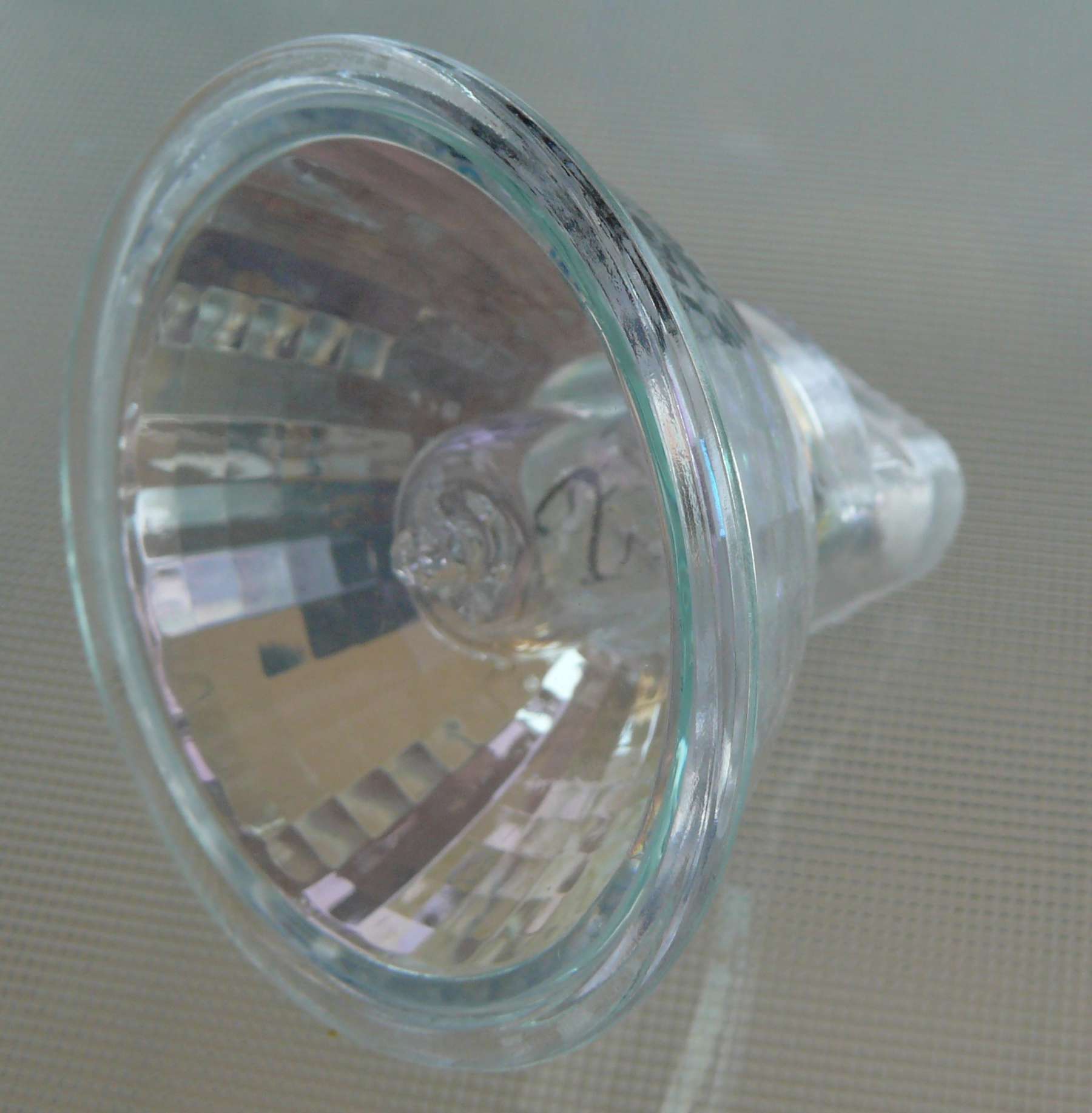

I am right on the cusp of going into the dreaded "DAC" [Domestic Alto Consumo] electric rate for excessive usage over the previous 12 months. To put that into perspective, if in the next week I use three kWh more than I used last year over the same time period, my bi-monthly July-August electric bill will increase from $27 to $105 USD. I take daily meter readings and analyze the data in a spreadsheet, so I know to the nearest kWh exactly where I stand.
It looks like I will squeak by this time, but barely, so I am looking for ways to save; even one kWh per week on average would do it. I am actually running the house pretty economically now as far as usage. If I exclude my refrigerator and the computers (with accessories like router, cable modem, VOIP phone) I am using one kilowatt hour per day for the entire house. That doesn't leave a lot of room for improvement. This isn't guesswork: remember I take and record daily meter readings.
I have 23 light fixtures in my house with halogen bulbs similar to the one pictured below, except that most, if not all of them are 50 watt, not 20 watt. What would I do to change over to LED lights? Can I get LED bulbs to fit the existing fixtures, or do I have to tear up my ceilings and cabinets and install new fixtures? How expensive is this?

That looks like a MR16 lamp with GU5.3 socket/base, but Rob would probable know off hand.
If that is correct, then Toshiba make something suitable http://www.toshiba.com/lighting/products/led-lamps/mr16-gu53.jsp although not quiet bright enough, they seem to max out at 35w equivalence.

That's a weird bulb, usually line voltage MR16 will have GU10 bases... you might have to swap out the sockets to use a line voltage led.

This would appear to be the manufacturer's page for that bulb, if that helps.

These are 12V, which is what I would expect in the UK with that GU5,3 connector. Exactly as Larry says, you would want to factor in changing the lampholders over to GU10.
What I would sell here is the Lampholder at 1.25, and a Megaman Modo 4.5W GU10 (42W Equivalent, non-dimmable, available in 3000K and 4000K) at 8.00, that's all inc Tax. This is all in 230V though, but I would imagine you would be able to find something similar in 110V in Mexico, at the same price you're looking at roughly 190 Pesos.

I reckon you need at least 11w LED to come close to a 50w halogen, 14w would be more convincing. Our new house has these:
http://www.orluna.com/products/mini_recessed.aspx
and these:
http://www.nationallighting.co.uk/LED_Lighting/LED_Fittings/LED_Downlights/LUCIDA/pid/988
The 2nd ones are probably as close to a 50w halogen as I've seen from an LED but definitely not GU10. I know that Phillips, Toshiba and others do higher powered GU10s but the Phillips (which I've seen) has a little fan in it (v annoying).
An alternative might be CFL GU10s, I haven't seen any in operation but might be worth a look:
http://www.tlc-direct.co.uk/Products/GUC...CFc0mtAodfi4A9Q

The LED light idea is a dead end for me, I think. In order to make my goal of <3,000 kWh for the previous year, I have (with her permission) run an extension cord from my downstairs neighbor up to my level, and am running the computer system and associated peripherals plus my refrigerator off of her electric meter. The entire remainder of the household is using slightly less than one kWh per day, and lighting is only a small portion of that. LEDs aren't going to save me much, certainly not on a cost/benefit basis.
Getting back to the original post, there's a company called Cree which manufactures LED modules for precisely this application. They announced these modules over a year ago and now, they appear to be "available" as ALT Asteria V6 bulbs, in several different color temperatures and light spread angles. There's one German vendor who has it for EUR 45 or thereabouts. I can't find an American reseller, making me wonder just how much these things are actually on the market, ready for sale.
