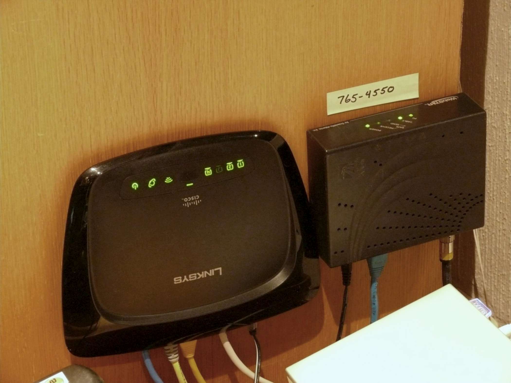

My internet connection has ceased to work. Sort of. I have a WRT54G2 router (the flat, sort of saucer-shaped one, see picture) that doesn't seem to be working right. I think. Maybe. This morning I could not connect to the internet, so I went to a DOS prompt (OK, for you purists, a pseudo-DOS prompt, there is no DOS in Vista  ) and found that I can quite reliably ping Google.com. I started my PingLogger program and for the past seven hours have not missed a single ping. My VOIP telephone (by OOMA, highly recommended) works just fine. My printer (which is also run through the router) works. But neither my computer nor SWMBO's Macintosh can connect. Nor can the downstairs neighbor's MacPro notebook, nor her iPod Touch. The latter two use the wireless aspect of the WRT54G2, while my computer and SWMBO's Mac are wired directly. The topography is simple: Cable Modem --> WRT54G2 --> various devices. Everything seems in order, except that none of the computers will connect to the internet. So... I bypassed the router and connected my computer directly to the cable modem (that's how I am writing this) and now nothing works internet-wise (printer, wireless, VOIP phone) except my computer. So the router seems to be the problem. I logged into the router (192.168.1.1) and all the settings seem to be correct, but what I know about routers and wireless connectivity is essentially... nothing. If the router is broken when trying to use a browser (and we have tried four different browsers: Firefox, Internet Explorer, Safari, and Chrome, plus whatever an iPod Touch does to connect), but my DOS prompt shows connectivity, what does that mean? I am way over my head here, and would welcome helpful suggestions. tanstaafl.

Mmm.. The topology suggests a few things to try.
Does the PC connect fine if plugged into the OOMA thingie in place of where the router normally plugs into it?
And does the Router work if you bypass the OOMA and plug the router directly into the cable modem?

And does the Router work if you bypass the OOMA and plug the router directly into the cable modem? I didn't see where the Ooma was in the topology. I believe the Ooma people prefer the base station to be inbetween the modem and router, but it isn't necessary, particularly if you set up QoS. Doug, you said in your original post that it goes modem > router. Is that true or is the Ooma in the middle?

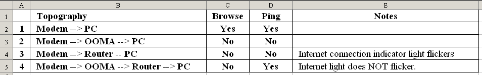

Does the PC connect fine if plugged into the OOMA thingie in place of where the router normally plugs into it? No. And does the Router work if you bypass the OOMA and plug the router directly into the cable modem? No. The only way I can connect to the internet with a browser is by hooking the PC directly to the cable modem. tanstaafl.
#350364 - 25/02/2012 03:11
Re: Router Desperation
Doug, you said in your original post that it goes modem > router. Is that true or is the Ooma in the middle? Sorry, I mis-spoke in the original post. After poking and prodding and scratching my head, I realized that the OOMA acts as a pass-through between the cable modem and the router, as shown in the diagram. From my uninformed perspective, it seems as though the router is the culprit here. If I don't use the router, I can connect. If I do use the router, whether or not the OOMA is in the loop, I can't connect. Should I try the "Reset to Default" thing as offered in picture #19? Or maybe just buy a new router? tanstaafl.

Does the PC connect fine if plugged into the OOMA thingie in place of where the router normally plugs into it? No. After poking and prodding and scratching my head, I realized that the OOMA acts as a pass-through between the cable modem and the router, as shown in the diagram.
From my uninformed perspective, it seems as though the router is the culprit here. If I don't use the router, I can connect. Didn't you just say you couldn't connect if you connected to the OOMA box, bypassing the router? To me it looks like the cable modem is the culprit if you can't connect when the PC is connected to the OOMA box and the router isn't even connected. Or was there some misunderstanding here?

With computer plugged directly into the modem: Unable to connect Firefox can't establish a connection to the server at 192.168.100.1. With cabling configured "normally" (i.e., everything through the router and with the OOMA in the middle of it all): The connection has timed out The server at 192.168.100.1 is taking too long to respond.
