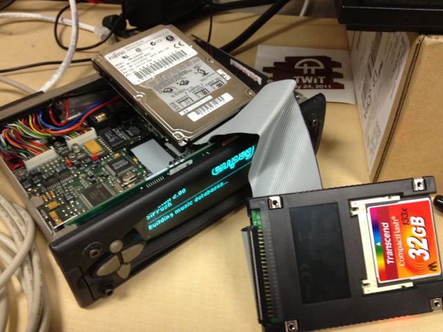

Still working on this, once I finally found time to install the adaptors, a flaw was discovered. The particular models I found indicated slave support when I looked at them in the store. Unfortunately it looks like the PCB is shared with a dual slot converter, and they put the slave jumper on both. The back side has pads for a second CF slot, and the adaptor does nothing when it's jumped to slave mode. Time to settle on an online adaptor and have it shipped since I have 2 good 32GB cards in hand.

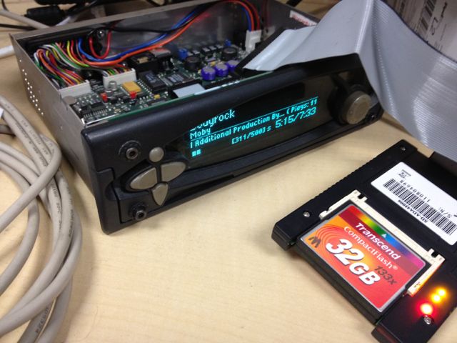

Ordered one of these (Syba Best Connectivity 2.5" IDE 44-pin to Dual Compact Flash Adapter) and verified it works great for the empeg. Plugged both cards in, attached the cable, and it just worked. The form factor is also perfect for mounting directly onto the hard drive carrier with no modifications needed. The adaptor doesn't do anything special to try and combine the two flash cards into one virtual drive though, so this isn't a solution to add 4 CF cards to a Mark 2 unit. With the Mark 1, this would be a great way to go though cheaply.
#348519 - 26/10/2011 21:12
Re: Current HD->CompactFlash status?
[Re: drakino]
Oh, and Mark, just for you  "cp /dev/hda /dev/hdc" None of that fancy dd stuff here. Letting the empeg clone my old drive right onto the CF card #1 now. Will clone the second card when this finishes. With 30GB to copy, I'm guessing this is a measured in days operation.
