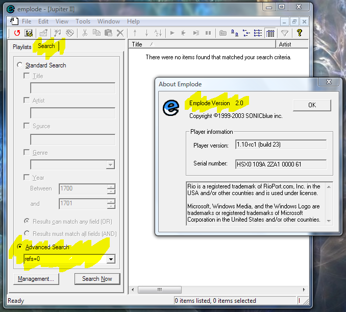

It's only 32bit Windows 7. I've tried putting the dll in windows\system32 and the directory I was running Jemplode from, and neither seemed to work. It's not really a big deal, i can do most of what I wanted with Emplode, however I couldn't find any way to find orphaned files using Emplode, only instructions on how to do it in Jemplode
#335231 - 21/07/2010 00:47 Re: jEmplode help [Re: JimCamel]
Try putting the DLL in the same folder as the Java Runtime Engine. That's what it says to do on the Jemplode page.
An orphaned file search is the same in both Jemplode and Emplode. Advanced search for Refs=0 .

I couldn't find the advanced search option in Emplode, guess I just need to look harder. Thanks for your help

A picture with highlighter pen is worth a thousand words.
