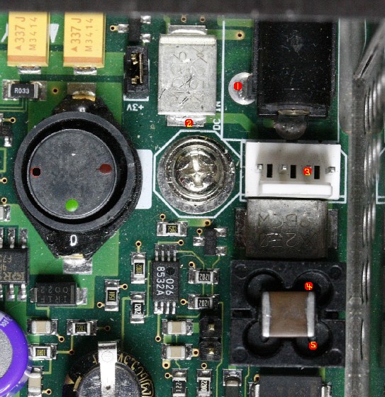

Here's a photo of the area just north of the PSU components.
The pair of blue jumpers (upper left) should measure 5.0 - 5.5VDC. If not, remove the jumpers, and measure from the right-hand pair of pins there. If still not, then the 5V supply is not working.
The single black jumper (upper right) beside that metal tab thingie is for the +3.3V supply. Again, it should measure about 3.3VDC. If not, remove the jumper and measure from the topmost pin. If still not 3.3V, then the 3.3V supply is not working.
That'll do for starters..

#316772 - 29/11/2008 04:47
Re: not powering up
[Re: crazyplums]
Posts: 14524
now, if i use the outer side of the psu plug to ground the _ probe, the same readings are apparent, but, if i let the - probe touch the chassis, it seems to damp the voltages down to what they should be. a small red surface mount led comes on (forward right corner) and a blue led (facing outward from rear centre). Ah.. waitasec.. blown fuse, I think. Between the AC-Adapter jack, and the +3.3V jumper, is a flat-ish silver thing. This is a 2.5A fuse, which connects the negative contact of the AC-Adapter jack to the ground of the empeg. It has two contacts where it is soldered to the board. Measure the resistance across the two contacts (should be zero ohms, but probably isn't in this case). -ml
Description: Blown fuse? The rectangular silver thing just below the screw.
Edited by mlord (29/11/2008 04:52)

No need to remove the pcb just to test it. In the photo above, the two contacts are at the top and bottom. Use nice skinny probes to avoid shorting the top probe onto the face of the fuse (won't hurt anything, but also won't test it properly).
If the fuse is indeed bad as it appears to be, then the whole pcb will have to come out to remove it and solder on a new one.
I don't know where to get the exact same fuse from, but it has a part number on the top surface, and is a 2.5A fuse. At worst, one could just get a regular axial lead style of micro fuse and solder that upright onto the pads.
Edited by mlord (01/12/2008 13:14)

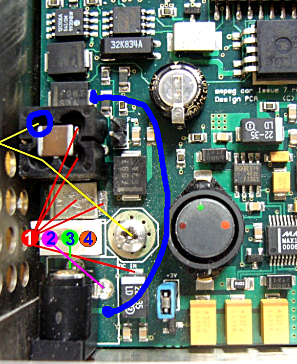

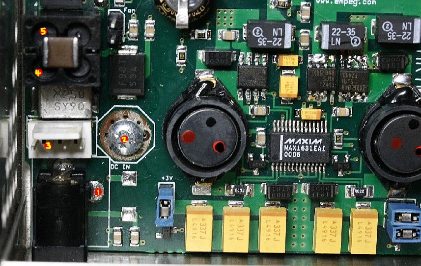

Here is another photo of the area under scrutiny. I have labelled some of the key test points, to ease discussion of exactly where to probe etc..
1. The outside (negative) contact of the DC power jack. 2. The 2.5A GND fuse contact (the top surface is the other contact). 3. The NEG(-) contact for the black wire (unplugged) from the docking connector. 4. A small coil that connects the fuse to the empeg ground plane -- the contact is deep inside the hole here. 5. The other contact of the small coil (I don't know which contact is which).
What you should do, is measure ohms between all combinations of those red dots, plus across the two contacts of the fuse itself, and post your complete findings here.
The ground circuit actually goes from points 1 and 3, through the fuse at point 2, and then through the coil (points 4,5), after which it finally connects to ground/chassis of the rest of the empeg.
There is a nearly identical lead-in circuit for the POS(+) side of the power, with a second fuse and a second half of the coil for that. But that stuff appears to be working in your player, so ignore it.

ah, i can see a difference already.
the fuse i was testing is between the 4 pin input plug and the coil. between 3&4 on your (very helpful) diagram.
where you have a fuse (fig2), i have a black component. markings on it are
22-35 LD 2
the empeg in question is a empeg car, ser No080000166 if that makes a difference.
sorry if i wasn't clear in the initial post, when i saw your pic with the screw and the fuse, i only saw the one in mine and didn't think to re-check your pic.
Hugh

right....
found another of the black fuses, or at least what i think is a fuse? used this as a guide to test the one i have in place of the silver fuse in your pic. both read 3.3 m/ohms across them
1 to 2 (unreadable, keeps increasing or decreasing in .5 increments, one reading it's m/ohms, the next k/ohms.
1-3 88k/ohms 1-4 10.01 k/ohms 1-5 10.01 k/ohms
3-4 81 k/ohms 3-5 80.7 k/ohms
4-5 1.9 ohm
1-chassis 9 k/ohms
did i miss any? any reading connecting to fig 2 (fuse) was not a steady reading, wild variations.
it looks like this pcb might have been out before, one of the pcb screws is a bit messy, think i'll take the pcb out just to see if the black fuse is a repair.

#316838 - 01/12/2008 20:21
Re: not powering up
[Re: crazyplums]
Posts: 14524
Oh.. you have a Mk2, not a Mk2a. Ignore all of that, then.
I'll post new instructions / photo shortly.

The component is a capacitor, 22uF/35V, and the line is positive side.
Without having a Mk2 at hand (I only have a couple of Mk2a, and they're not at hand either), it looks like the fuse is blown. Did you check the fuse? Those m/ohms you reported earlier, that was Megaohms, not milliohms, right?
Stig

i think it might be the dc jack.
going by the image above, the neg is the pin on the right of the jack with the number 1 on it,
the neg side of the dc input is obviously going to connect with the flat spring connection on the inside of the female jack, and the pos to the pin in the female jack.
using a simple continuity test, there is no connection between the flat inside the female, and the No1 connection shown above. the pos tests out fine.
however... there is a neg continuity to a pin directly underneath the jack socket. due to the pcb being quite thick and multi layered i cannot see where this leads too, even holding it to a 300w light!
I have to admit, this pcb is some piece of work, when i was building boards (QC / test, hand finishing chips etc) back in 90/92, it was all big resistors, caps, etc. i knew all the resistor values by the colours, what the numbers meant on other components, etc, i don't even know what half of what i'm loking at in the empeg is!
surface mount stuff was barely seen, and when i say surface mount, i mean like on the empeg board, most components a fraction of the size i dealt with, and soldered on top of the board, not behind it. I've fixed many a device by tracing earthing / power faults on the pcb themselves, broken / burnt track, etc, and repairing them, but i wouldn't want to attempt this baby! heck, even my fine tips on my irons are twice the size of the smallest solder joints on the empeg!
still, i was 15/17yr old when i used to do all that, latterly more used to fixing circuits etc that you could poke your finger into if you'd not got a probe! not even done them for 4 years!

Posts: 14524
Just read a bit further up the thread again and saw you had tested the fuse already. Broken trace somewhere between fuse and coil, maybe?
Stig The Mk2 has only a single power fuse, on the +12V input. His player appears to have a break between the GND input and the empeg mainboard ground. So the fuse doesn't enter into it. And from the measurements given, it pretty much has to be in (or very near to) the DC power jack itself. Time to dig out a magnifying glass, and look VERY VERY closely at the pads around number 1. Maybe look at the backside of the board too. Is the DC jack *really* connected to an unbroken/unlifted pad on the mainboard ? Cheers
Edited by mlord (02/12/2008 11:49)
#316859 - 02/12/2008 11:55
Re: not powering up
[Re: crazyplums]
Posts: 14524
i think it might be the dc jack. Oh, bugger! I got the jack pins confused. Number "1" in my photo is meaningless.. you need to test against the third post, which goes through the board and is accessible from the underside. EDIT: very important: plug the AC-adapter into the jack before measuring -- but DO NOT PLUG IT INTO THE AC MAINS! Just a quick ohms from there to numbers 3, 4, 5 will do nicely. Cheers
Edited by mlord (02/12/2008 11:55)
#316860 - 02/12/2008 11:56
Re: not powering up
Posts: 14524
i think it might be the dc jack. Oh, bugger! I got the jack pins confused. Number "1" in my photo is meaningless.. you need to test against the third post, which goes through the board and is accessible from the underside. EDIT: very important: plug the AC-adapter into the jack before measuring -- but DO NOT PLUG IT INTO THE AC MAINS! Just a quick ohms from there to numbers 3, 4, 5 will do nicely. Actually, I believe the third post is also accessible at the bottom solder pad in my photo -- where the NEG side of that extra capacitor you have it is soldered on. EDIT: actually, that capacitor is not extra -- it's simply missing for some reason from my own Mk2 unit here.
Edited by mlord (02/12/2008 12:01)
#316862 - 02/12/2008 11:59
Re: not powering up
Posts: 14524
..and after you confirm that the jack is indeed broken, email me your postal address and I'll mail you a factory replacement jack. That's assuming you can desolder the old one without frying the board (both things are easy to do..) and then solder on the new one.

thanks Mark,
new readings, male jack inserted,
ground pin (1) under jack / pcb.
to ... earth / screw 2......... 16.4 k/ohm pin on male plug 3....... 3.2 ohm coil 4........... 16.4 k/ohm coil 5......... 16.4 k/ohm
from side pin
1-2, 9.9 k/ohm 1-3, 26.3 k/ohm 1-4, 9.9 k/ohm 1-5, 9.9 k/ohm
male jack not inserted...
from underside pin,
1-2, 8.7 k/ohm 1-3, 3.1ohm 1-4, 8.85 k/ohm 1-5, 8.85 k/ohm
from side pin
1-2 8.82 k/ohm 1-3, fluctuates 13-14 ohm 1-4, 8.8 k/ohm 1-5, 8.8 k/ohm
thanks again,
replacing the plug shouldn't be a problem,
Hugh

Okay, the ground contact (connects to middle/bottom pin of DC jack) has broken from metal fatigue. The DC Jack must be replaced. Email me if you want a (free) new one sent to you by post. mlord at pobox daht com.
btw, that fuse is a resettable 2.5A part; it shouldn't ever totally blow... well, unless it gets so hot that it falls off the board (which has happened before now). It'll open at about 2.5A and re-close when it cools. Hugo ps Nice diagnostic work

Loc: E.Sussex, UK
ok, new batteries...
1-2 8.9 k ohm 1-3 3.3 ohm 1-4 8.9 k ohm 1-5 8.93 k ohm
2-3 8,75 k ohm 2-4 3.3 ohm 2-5 3.4 ohm
3-4 8.8 k ohm 3-5 3.4 ohm
4-5 3.3 ohm
to chassis... 1, 18.8 k ohm 2, 3.3 ohm 3, 8.75 k ohm 4 & 5 3.3 ohm.
3.3 ohm across meter probes.
regards, Hugh

Which photo are those numbers refering to?
#318694 - 31/01/2009 14:45
Re: not powering up
Registered: 29/12/2006
Posts: 159
Loc: E.Sussex, UK
your photo, 1, being neg on the pcb/jack, 2 being the screw head, 3 being 2nd pin from left of the four pins, 4 and 5 being the coil thingy!
thanks. Hugh
4-5 3.3 ohm Okay, that makes zero sense. Can you double check that? Because.. if 3-5 == 3.4ohm, and 4-5 == 3.3ohm, then there's no way that 3-4 can be 8.8kohm. Unless a diode is involved. So what does 4-3 show, versus 3-4 (probes reversed)?

[/quote] 3-4 8.97k ohm 4-3 8.93k ohm 3-5 8.96k ohm 5-3 8.94k ohm 2-3 8.9k ohm 3-2 8.92k ohm HI MArk, results above mate, think i've mentioned before.. it's been 18yrs since i knew one resistor from another, resistors don't even look like resistors anymore!! Ohms make little sense to me now, over the years i've needed to use those skills less and less, until now, if i'm looking for a broken track or something i tend to just test for continuity between two points, I've had the odd success... jumped 5 broken tracks on a sony tv i dropped, but never on anything this small! anyways, as ever, your help and patience is much appreciated, Hugh ps, compare your pic and mine, i have an additional diode(?) to the right of the jack (dc in), make any difference? it's the same as the row of three top right of the pic.

Okay. To repair it, you will need to add a new wire, between the underside post of the power jack to the black capacitor, as shown by the blue wire I have added to your photo below. You can add this wire either on top of the PCB, as shown, or by routing the bottom end of it from the pin of the power jack from the underside of the PCB. This is the ground (or NEG pin of the power jack. EDIT: The extra blue circle on the photo shows which pin of the EMI suppression block we are actually routing the new wire to. If you add the wire to the underside of the board, then you can probably run it from the DC jack to this exact pin, rather than to the capacitor on the topside. Might be tider that way. You cannot run the wire to the blue circle on the topside of the board, though -- don't even try it!This fix replicates what you previously discovered by shorting the NEG contact to the empeg case, except it does it safely, and routes it through the original circuit path for EMI suppression. Cheers
Edited by mlord (01/02/2009 14:28)
#318714 - 01/02/2009 14:24
Re: not powering up
Posts: 14524
Note that the extra black capacitor in your unit (absent from the photo I posted of my unit), is optional, and you could remove it if you like --> which would give you a nice easy place to attach the blue wire, at the bottom contact pad of the capacitor.
You might even manage attaching the wire there without removing the capacitor, but that other little cap below it might fall off in the process..
#318716 - 01/02/2009 14:50
Re: not powering up
Posts: 14524
Before you add that new wire, dig out the ohmmeter again, and verify that there is about 8Kohms of resistance right now where the blue wire is suppose to go.. Just as a double-check on things, you know.

ok, checked the ohms out at 8kohms again and i've done the initial repair, checked the ohms were the same all around.. all good at aprx 3.7ohm, re-assembled the player and..... doh! still not powering unless i short to the chassis, here's the repair (finest wire i could find i'm afraid) on the underside of the board,  i also noticed inside the chassis, a scorch mark,  and another identical on the edge of the pcb, right next to the suppressor coil thingy leg.  can't see how it's happened unless something fell in and shorted it out? the fuse is still continuous,

ok, we're there!!! after a quick re-think i've moved the jack end to the ground pin directly beneath the socket,  reason being that i could see this pin connected directly to the pin below, where as the one to the right, as originally connected to, was not going to contact with the ground of the plug due to insulation on the end of the plug. (the repair isn't as messy as it looks in the pic!! though i need to replace with some finer wire and clean the pcb when i get time!) a quick check of the ohms (3.7ohm) and power up...  so far so good, connect the hard drive...  bingo!! all seems to be fine, the only thing i can see at this moment as being 'not right', is the remote for my other player doesn't work with this one (empeg car), and the software needs updating as the menu seems to be different (mainly visuals) to the other later) empeg rio car. i'll re-assemble the player shortly, once you've had chance to re-assure me that all is as it should now be, and then get around to upgrading the drive and the software! next will be a way to figure the player to connect via a network to reduce the ludicrous upload time for 25-30gb of music! huge thanks for all your help, Mark (and others). Hugh
Edited by crazyplums (04/02/2009 12:32)
#318809 - 04/02/2009 13:28
Re: not powering up
[Re: crazyplums]
Posts: 14524
Ah, much better! And thankfully, the nature of the original fault meant that you couldn't really hurt anything at all by having the wire in the wrong place originally!
As for the black marks, those confirm that the internal ground trace was indeed blown (open circuit), so our replacement wire (that wire *is* the right thickness, by the way) is totally correct, routing around the fault.

Mmm.. you know what? An even safer way to repair this kind of fault would be to use an axial lead 1A fuse in place of the jumper wire.
A minor fault with the original design, is that the fuse on the +12V wire generally doesn't seem to protect the circuit -- the PCB ground trace burns out before the fuse blows.
So shunting the new ground wire using a fuse rather than plain wire might protect things better.
I'll try and remember that for next time. I even have some of the right style of fuses here -- long skinny things with lead wires on them, which look very much like traditional resistors.
