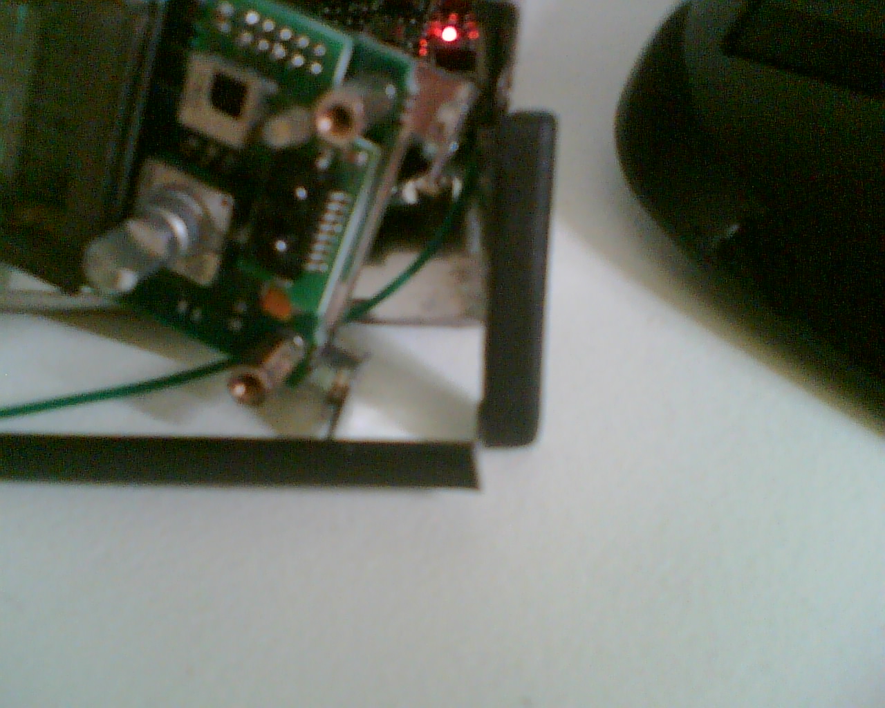

#310617 - 29/05/2008 13:30 broken handle
Boelle
Registered: 22/11/2007
Posts: 475
Loc: Denmark, Odense
can this handle be repaired?
when the 2 parts are put together they fit and you cant tell it's broken (you have to look close)

Yes, that can be repaired rather easily, by drilling in from the side, lengthwise along the handle. Then tap threads and bolt it back together. Or glue in a pin instead of the threads/bolt method.
Another repair method, stronger but more intrusive, might be to slice a thin slot through the corner section (from bottom/side), and then fill it with an angled metal plate, pinned (rivets or screws) in place.

will the screws be sticking out for will it be a flat surface?

One screw, flush. The screw head could be covered with expoxy and painted black afterwards, if you want an invisible repair.

The repair attempt (for Boelle) failed --50/50 chance, and we hit the wrong 50.
I think any machinist could fix it for you, though, with better odds than 50/50.

That's what we tried here. But the thread tap broke off in the hole..

My other idea, which I may someday try on the broken handle I have here, is to slot the ends of the two pieces, and rivet a small spline into them, bridging the break. This will work, and will be very solid. Just takes a bit of effort.

I repaired SWMBO's broken handle.
The repair was crude, and the final results were not especially pretty, but it worked.
I used a small drill bit (probably a 5/64" or thereabouts) and drilled about a half-inch deep hole into each jagged broken end of the handle. Then I broke a 1" piece off the fluted end of the drill bit and inserted it with a generous dollop of JB Weld into each of the holes I had drilled, applied more JB Weld to the outside of the handle around the break, and held the handle tight together while the epoxy set.
This repair has lasted for more than a year with no problems.
