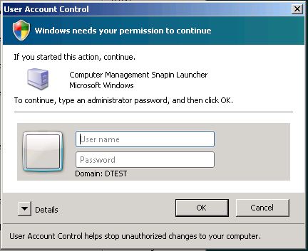

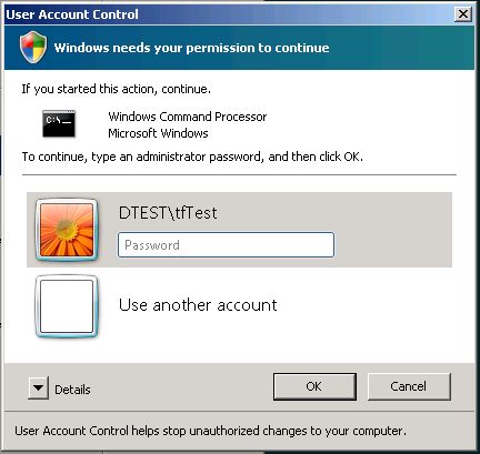

I've got a situation where a bug repros on one vista machine but not on another vista machine. We think we've got them configured pretty similarly, but they behave differently one crucial way that we *must* nail down in order to prevent a bug in our software.
I am going to attach two pictures of elevation prompts, one that I will consider "bad" and one that I will consider "good". I'll attach them and then continue my question in another post...
Description: This one is Bad. This is the one we don't want to see.
Description: This one is good. This is what we'd like to see every time.

On the machine I'm testing this on, I get the "Bad" one when I try to elevate CMD.EXE, but I get the "Good" one when I try to right click on My Computer and hit "Manage".
I can also make the "Good" one appear every time if I log into the computer as a user in the local user's group as opposed to a user in the Doman Users group. But we want the "good" behavior every time. And anyway, I've got another machine here that gets the "good" behavior every time, regardless of whether it's a domain user or a local user.
See, the problem with the "BAD" box is this: You can get past it by entering cheap credentials. Credentials of just a joe-user-guy. It returns, making the calling application think that the guy entered proper admininstrator credentials. But he didn't.
I can even fool Windows itself with this one. If I try to elevate "Command Prompt", and I get the "Bad" Box, and I enter joe-user credential instead of admin credentials, IT LETS ME, and it even says "Admininstrator" at the top of the box as if I'd really elevated. But I haven't, and I find that out the hard way when I try to do anything administrator-like from within that box, it keeps giving me "access denied" errors.
The "good" box is different. It won't let you past it unless you truly enter some admininstrator credentials. When you come out of that box, if you didn't really and truly elevate, you get an error message saying "this requires elevation <OK>" and whatever called it, fails out. As it should.
Does anyone have any idea what governs which of the two boxes is the one that's going to appear?

Admins get a different prompt than restricted users.
Admins get no login box at all. Admins get a "Continue" button and that's all. So that's not it.
The users are (as far as I can tell anyway) identical in terms of their permissions. In both cases, they are members of the "Domain Users" group only.
